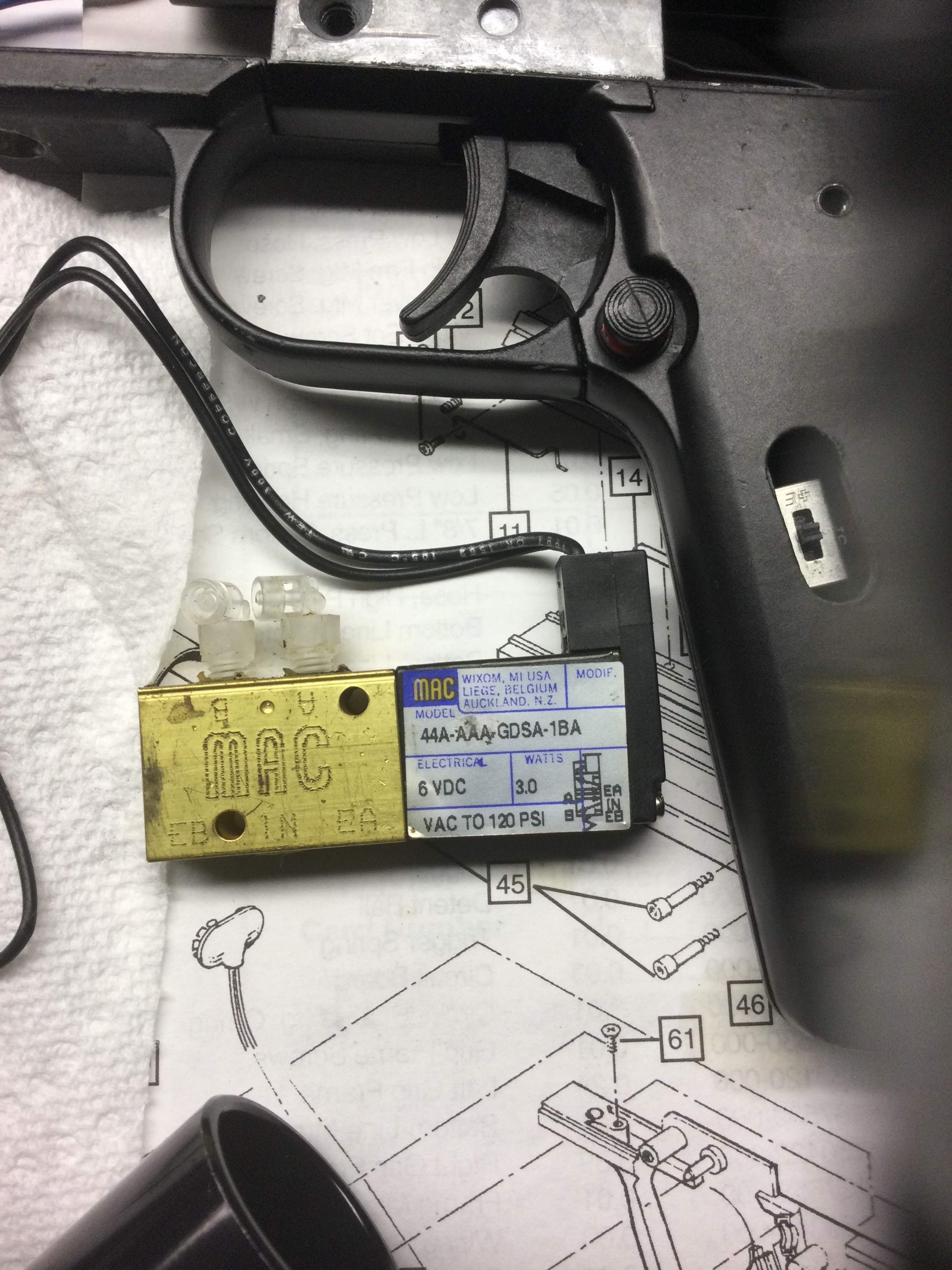

Does anyone know what model number Mac valve is on the 9 volt rainmaker?Im working on select fire rainmaker and it’s missing the mac valve.

They're not available anymore, but if I remember correctly a 43 series 4way valve be substituted. Realistically any 4way solenoid can be used, the board has more than enough juice to fire anything I've hooked up. -
This is the one in mine. And it runs off a 9v.

Looks like the same Mac valve and specs as RainmakersAttached FilesComment
Yup, same MAC valve for both generations.Hey guys thanks again for all the help.I wasn’t sure if there was a diff model for the 9 volt.I think these 2 rainmakers I’m working on will be my last.Starting to burn out on them haha.The parts are on life support.I have a Mac valve laying around that I’m going to try.But hey Jordan keep up the good work on the parts library.That Will prob be the only thing left to fall back on in the future.
