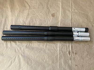

        But if you want to go extreme you can get a barrel rethreaded in Raptor threads that’s a smaller bore size. I got .676 and .682 Disruptive one piece barrels done like this. Because I have never seen the fabled Raptor freak barrel back, I also got a Dye barrel back rethreaded and freak bored to fit my Raptors. Only certain barrels will work since the threads are so far up the barrel. I think Palmers could also make you a brass barrel in Raptor threads.
        If you want to do something like freak boring, you have to get a barrel back that can be freak bored from the front/muzzle end instead of the back end of the barrel. The upper tube on the Raptor body is larger than the o.d. of a freak insert and will allow the insert to slide back into the gun. That’s why I couldn’t just get a AC or Spyder freak back rethreaded.
        Additionally, the barrel has to have a small enough o.d. so that it doesn’t interfere with the lower tube valve plug on the front of the gun. Which is why the barrels in the pic had the o.d. shaved down slightly up past the threads.
        I have obviously done a lot of trial and error with this and Brandon at BMC is more well versed in Raptor barrels that he probably ever thought he would be.
