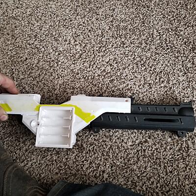

    Hey, so I have a Stingray 2 I was thinking on sinking into a stock. But at the thrift shop the other day, I managed to pick up 6 different nerf guns for less than the price of one new one. I've seen a few tutorials of guys who've put a paintball gun inside a nerf gun, but I'm taking a different approach. I'm chopping up bits and pieces of these nerfs to panel my Stingray with. The feed neck has been chopped off for a hand load first strike setup, and the nerf panel I'm putting over that has a lovely little sliding access door to go over that. Tonight I'm sanding and trimming that particular nerf piece, but I'll get back to you with pictures and some more plans soon.

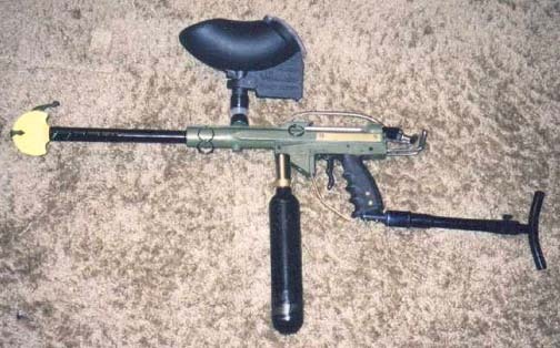

        Google what the Tippmann A5 bottomline adapter looks like. You could probably make one for the stingray since it’s a similar setup. Aluminum block filed to fit into the bottom of the hollow grip snug, two holes tapped in the bottom to bolt a stock to, and a hole drilled through the grip and aluminum block with a bolt going through to hold it securely.

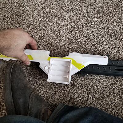

              Here's the general idea thus far. Battery box is getting trimmed out but the cover will remain

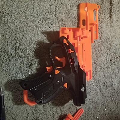

                  Okay, so I decided to do the nerf gun handle with a trigger relocation. Moving the whole thing back a few inches. The best part is... The nerf gun was electric. The bottom trigger below the trigger guard was to spin up the electronics, but you also couldn't pull the regular trigger without holding that first. Remove the electronic switch, and presto! Built in safety. Still have to trim back some of the orange plastic up top.

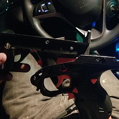

                      Just today chopping into the paintball handle to create some good mounting points for the nerf handle. Still needs a little more material removed to fit, but it's proceeding nicely.

                    So, still working on the handle. Chopped the handle off at the guard and cut out the back of it. Drilled a hole in the front of the handle stub for the linkage. The key now is sanding the handle molding flat just in the notch I cut out. This stuff is tough and I really don't have a whole lot of room to work

                      This is pretty much how the handle is going to line up. I'll make some panels to cover the original trigger and linkage. Sorry for the poor lighting.

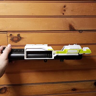

                        A little bit different plastic than I was planning to use, but this one worked better. Almost have it fit up. Sorry it's been a while.
