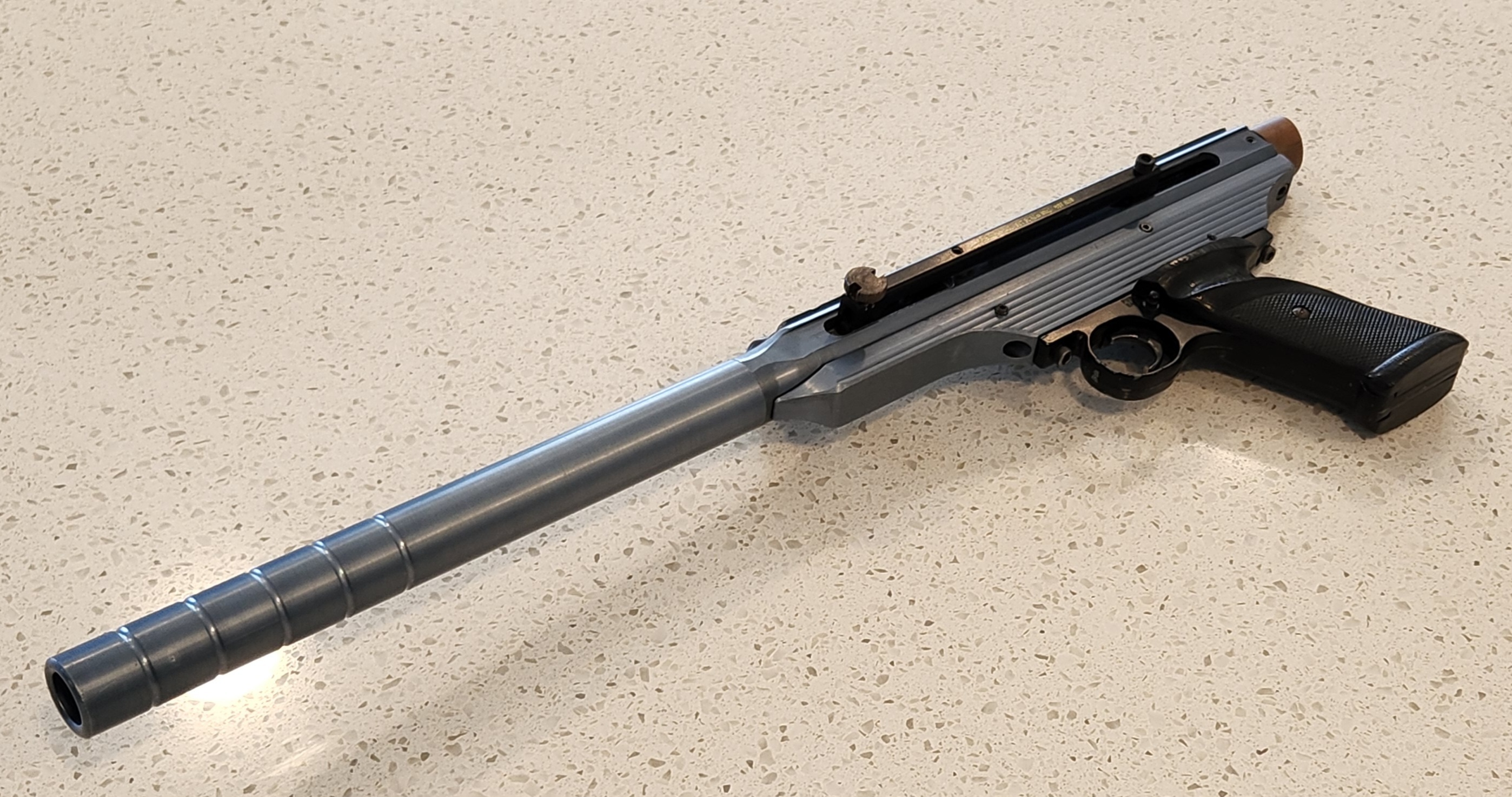

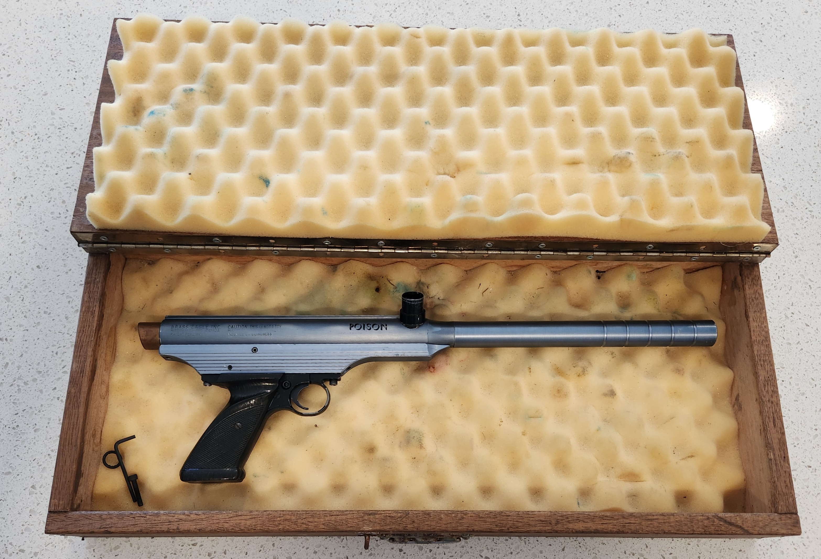

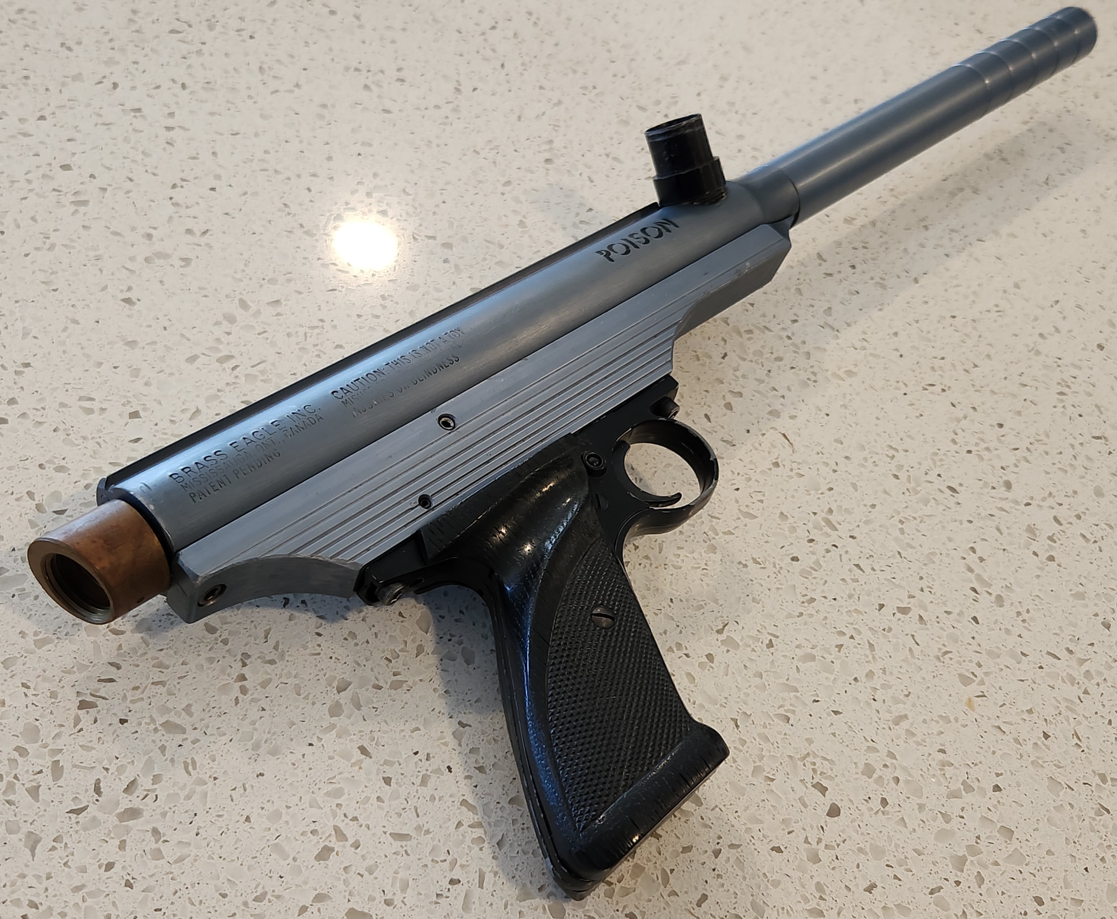

    I remember seeing and playing against people with these in the 90s. I was using a PGP most of the time and though oh crap. Never got the chance to shoot one, even now...no paint!

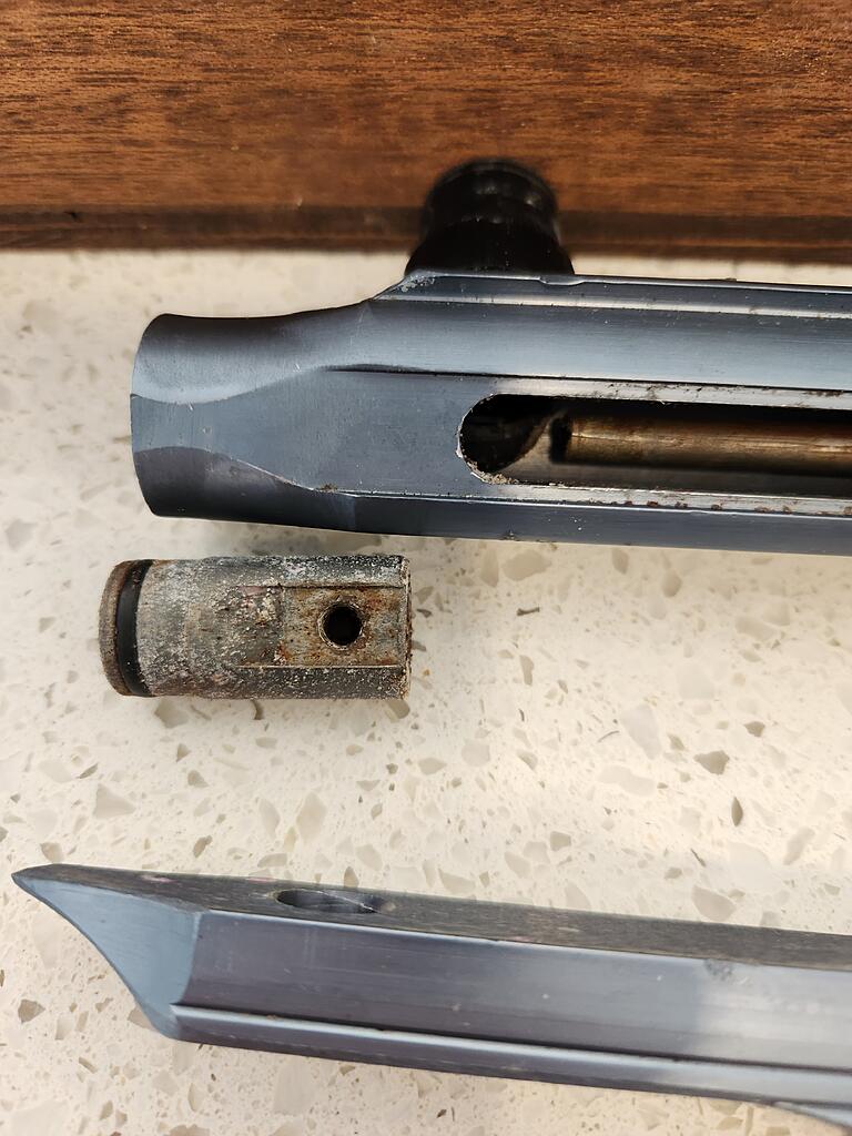

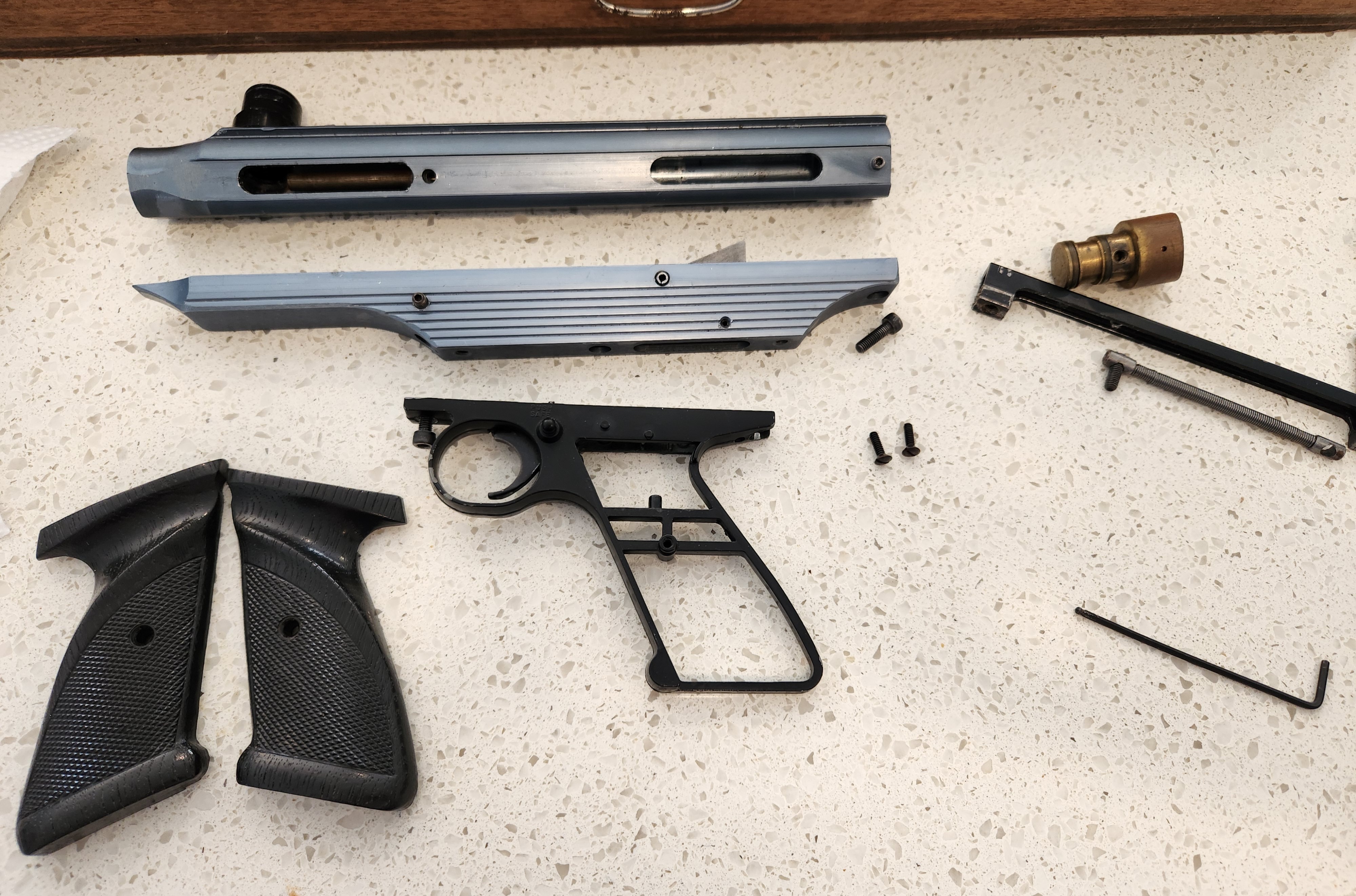

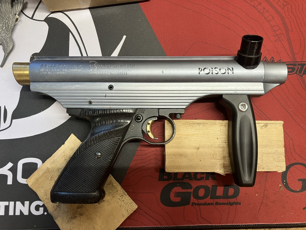

    Took it all apart but for the valve (no tool) and gave it a good bath. This was dirty inside, probably hasn't been used in at least a decade. Wasn't bound up though so everything came out ok.
    I cleaned up the bolt and hammer so they were smooth and lubed everything up. Once back together the bolt and hammer were moving nicely. Put some air to it and it sealed right up nicely.
    After shots...

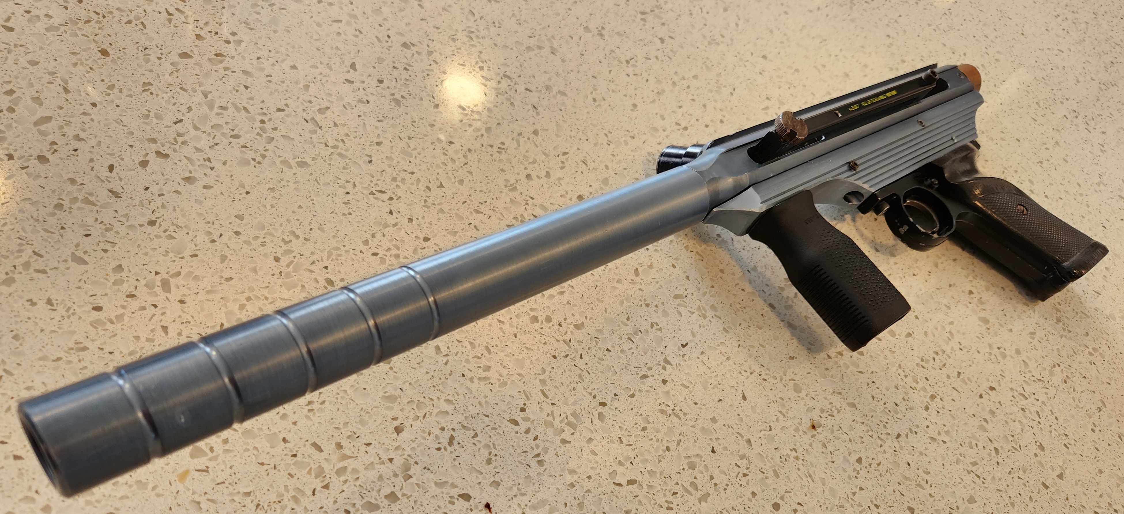

      This is just a quick mock up of a Lukes Automag grip I had sitting around. So I think it would be pretty easy to add a foregrip of some kind. Personally I would like to get a 3/4” diameter brass foregrip with the horizontal lines milled into it.

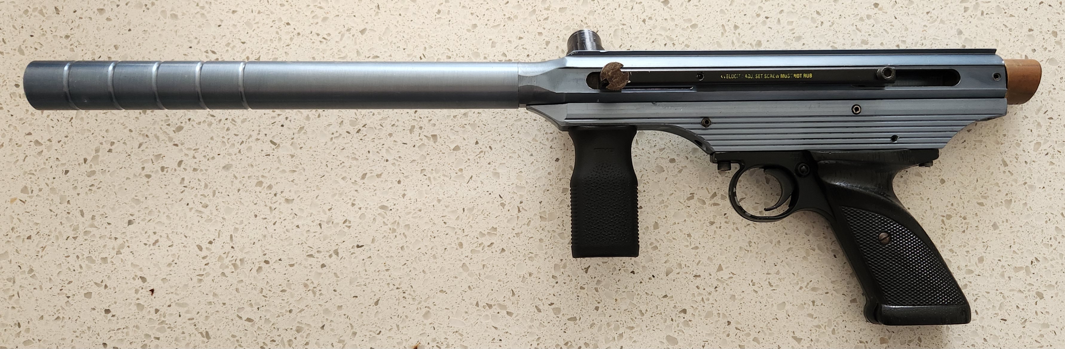

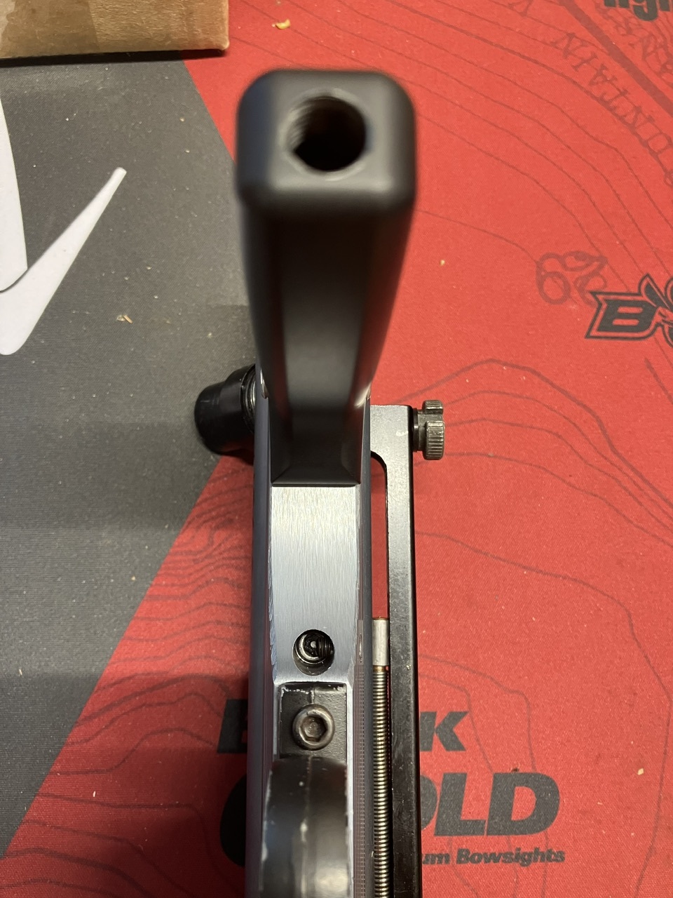

      Well, I added a Magpul foregrip to my Poison. I Tapped two holes, the front hole is the detent hole bored trough then tapped. It makes it much easier to hold.
