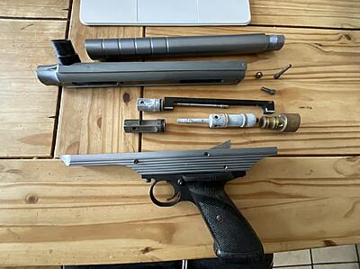

    So this is a gonna be a bit of a project. Hopefully I have all the parts and can get it working. Even got an old service request from the old field.
  • James_Blond
    • 157
    It’s functional so far… I had to take the set screw for the front rail screw and temporarily use it as the velocity screw/ front hammer spring screw as the few grub screws I had are too short. This is only a temp fix as it is still to short but long enough to test. Aired it up on a CA-II lever stock and it dry fires reliably. Can hear a slight hiss from the valve area. Not sure if its the two urethane orings around the valve body or if it’s internal to the valve.
    Found a couple random buna. orings for the CA adapter for now. Need to shorten the screws I have for the hammer and bolt rail as they are slightly too long. Also there is a bit of a gap between the body and rail so the screws that were in the box might not be the original ones for it. So they might need to be cut down slightly to fully snug the body and rail up, unless this is the way the gun is?
    So gonna need a trip to ace for some screws, possibly orings if they have what I need, and to polish up all the internals to get rid of the heavy oxidation. However, it does look like I might get this functional this week.
    sure does have some kick. Kinda like a vm68 but somehow slower?

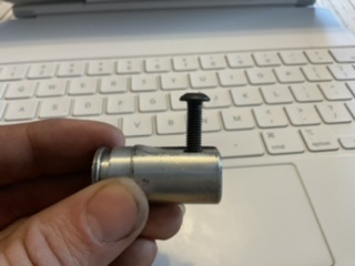

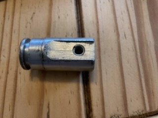

        Okay, little update now that the p68-AT is fixed and waiting on the some parts.
        So on reassembly I noticed something strange. Almost every screw on this gun is 10-32. Set screws, grip frame screws. The rear linkage arm screw to the hammer is 10-32, however I noticed that the bolt to linkage arm screw is fitting kinda loose. Looking more closely I thought maybe the peaks of the threads on the bolt may be worn down, and this may be true, but the linkage arm hole to the bolt is slightly bigger than the hole to the hammer. I need to go check my shed for a 12-24 but the bolt threads look fine and the 10-32 does thread in pretty well. So I’m almost thinking it might be a 12-32? This size appears to be quite rare after a quick google search and might be hard to source. I wonder if it could be a metric size that got used for some reason?
        So the gun remain down at the moment to I can either find the right screw or if it is getting worn out, I’ll have to either tap for a size up or helicoil the bolt body, but there isn’t much meat to the side wall of the bolt as it is riding on a powertube.
        • James_Blond
          • 157
          So a metric m5 fits a bit better than a 10-32. Might be a little bit sloppier than will hold up for a ton of cycling, but gonna have to go with it for now. M6 is way too big. Looks like long term, i may have to helicoil the bolt, though there is only about 1/8 worth of material to do it with and then grind down the helicoil. Or I may have to end up sending the bolt out to Doc or somebody to make a new one.
          • James_Blond
            • 157
            So I couldn’t find an m5 long enough to work. I’ve got some 10-32 helicoils on the way, which should arrive Monday or Tuesday. If that doesn’t work I’ll have to try something more substantial.
            Also I cut the frame to body screw way down so there is no longer any visible gap between when tightened down.
            • James_Blond
              • 157
              So it isn’t perfect, but is functional and is a tight fit after installing the helicoil. Gun is cycling but shooting low at 160-180 on 12g. It likes to chop everything with my rotor but shoots fine hand loading. Velocity screw is backed all the way out so I think I need a bulk co2 tank and it may be getting too much friction and slowing the hammer down as well. Might be able to swap the valve spring for something lighter.
