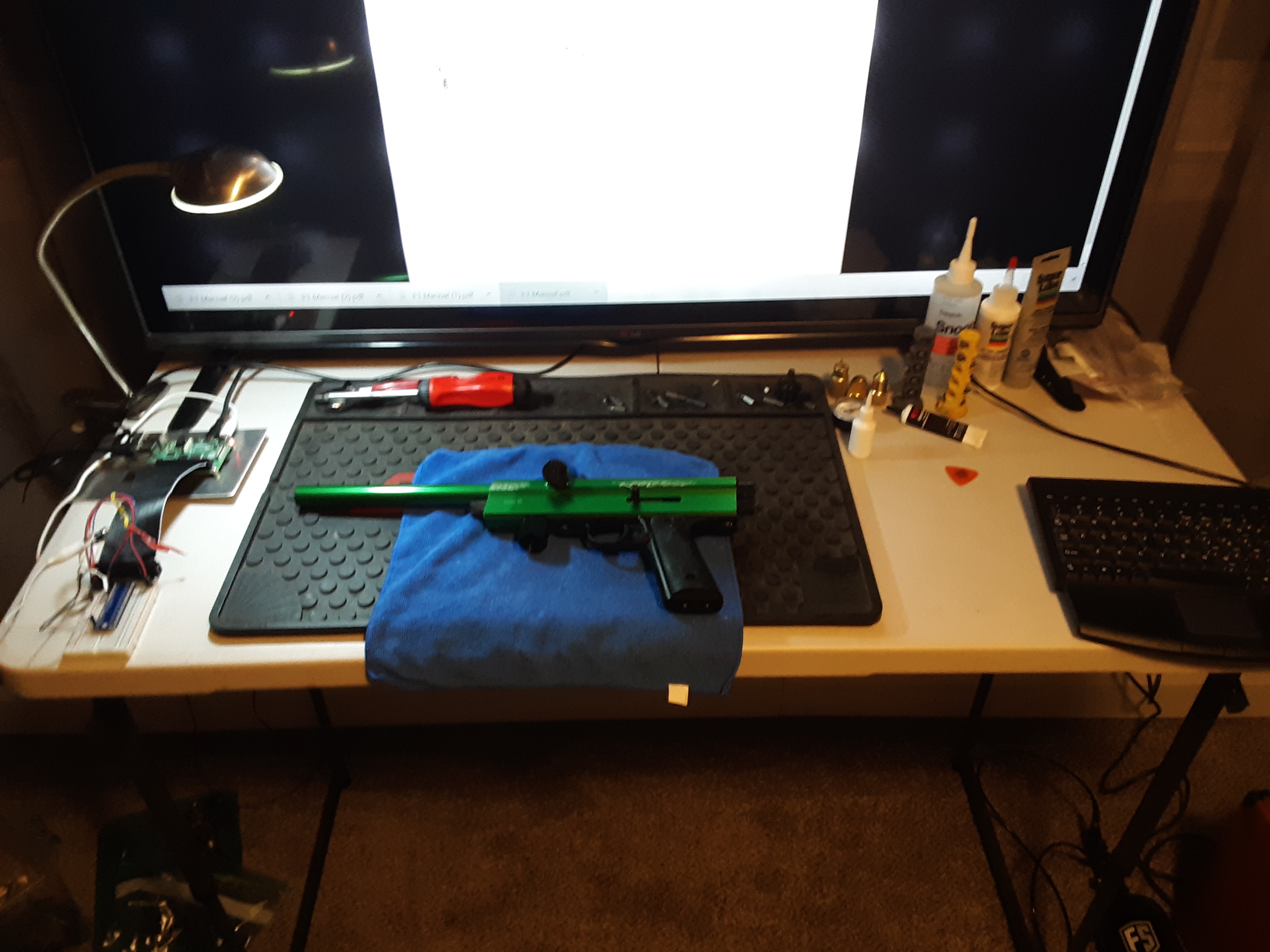

    I am curious if anyone has a comprehensive list of o-rings for the raptor. I am working on putting one together (waiting on my o-rings to arrive and verify they fit), but it would be nice if someone already did the leg work.

    All O-rings in the upper half (Bolt tube) are -016.
    All, except 1 on velocity adjuster screw, in the lower half (hammer tube) are -013.
    The velocity adjuster screw was a -008
    Base of Raptor Extreme foregrip is -117

            Ahh okay, nevermind. I have seen those. Then the answer to the question is yes this is a machined aluminum raptor. Not the plastic version.
            I'll see if i can source the replacements at my local hardware store over the weekend. Everything is all cleaned up awaiting new seals and some lube. Thanks for the help.

              Edited the first post. Thank you for the help gentlemen. I'll post up pics after I reseal the raptor Extreme
