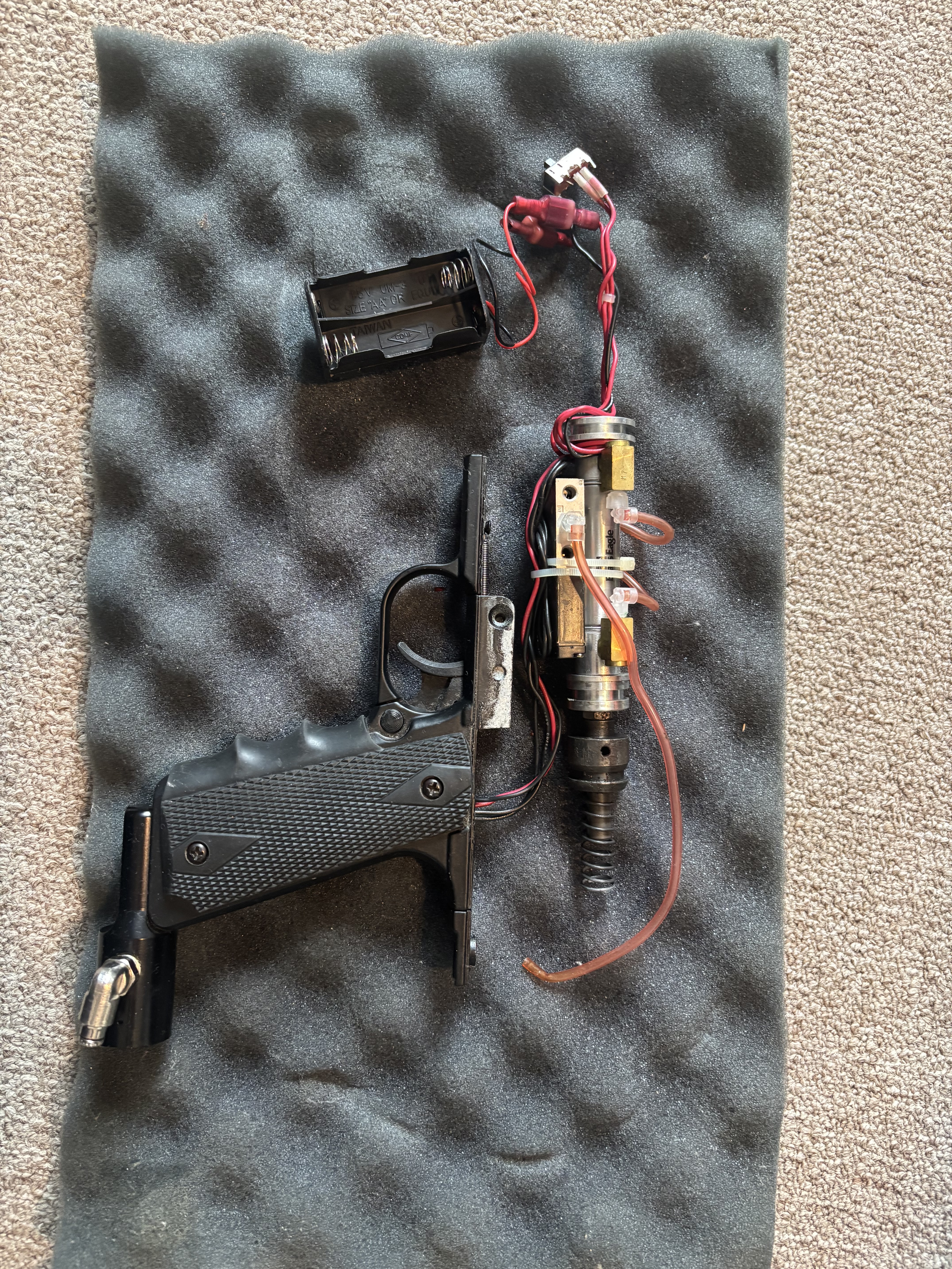

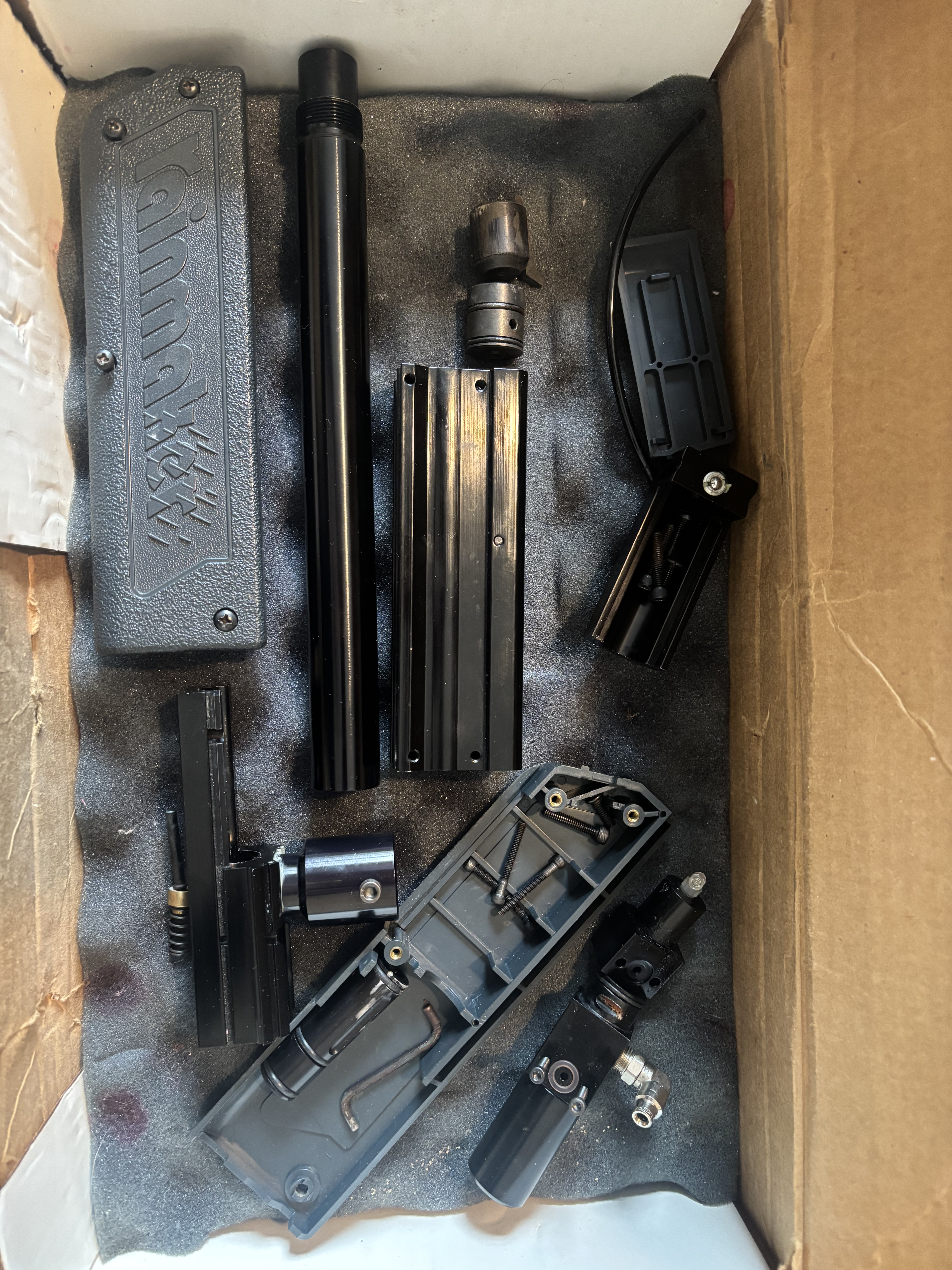

    Finally took this thing apart after sitting for decades as I plan on getting it in running order. Aside from o-ring replacement and lubrication, is there anything else that you guys recommend I do while apart? Thanks!

    Look up the Mad Marty Mods that were designed to stop the RM from shooting itself apart.
      I. Am. Canadian. 🇨🇦
      • 3508
      Mad Marty mods - found here:
      https://www.mcarterbrown.com/forum/p...er-information
      I'd recommend a new mainspring, checking carrier spacing, and gutting the regs and replacing them with aftermarket ones as well.

        Feedneck mod to empire spec, so you can actually clamp on a hopper instead of using a screw.

          I ended up drilling a hole in my revy to “lock” it in place because of that
