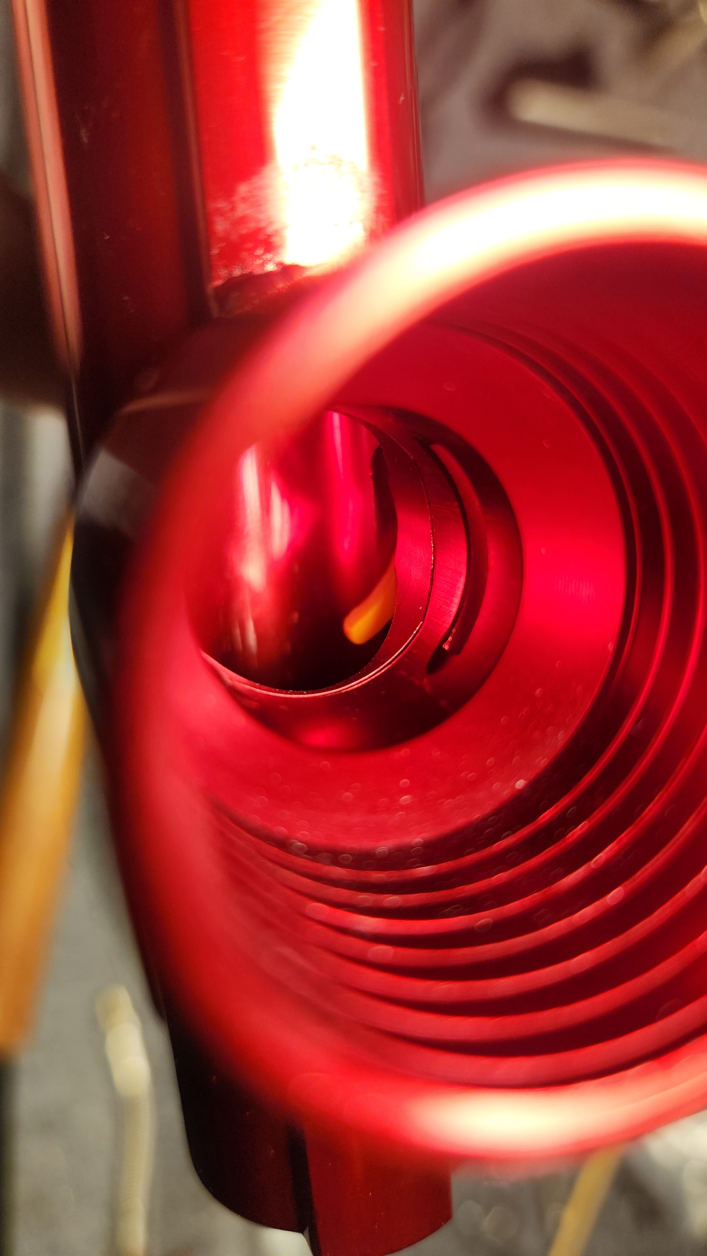

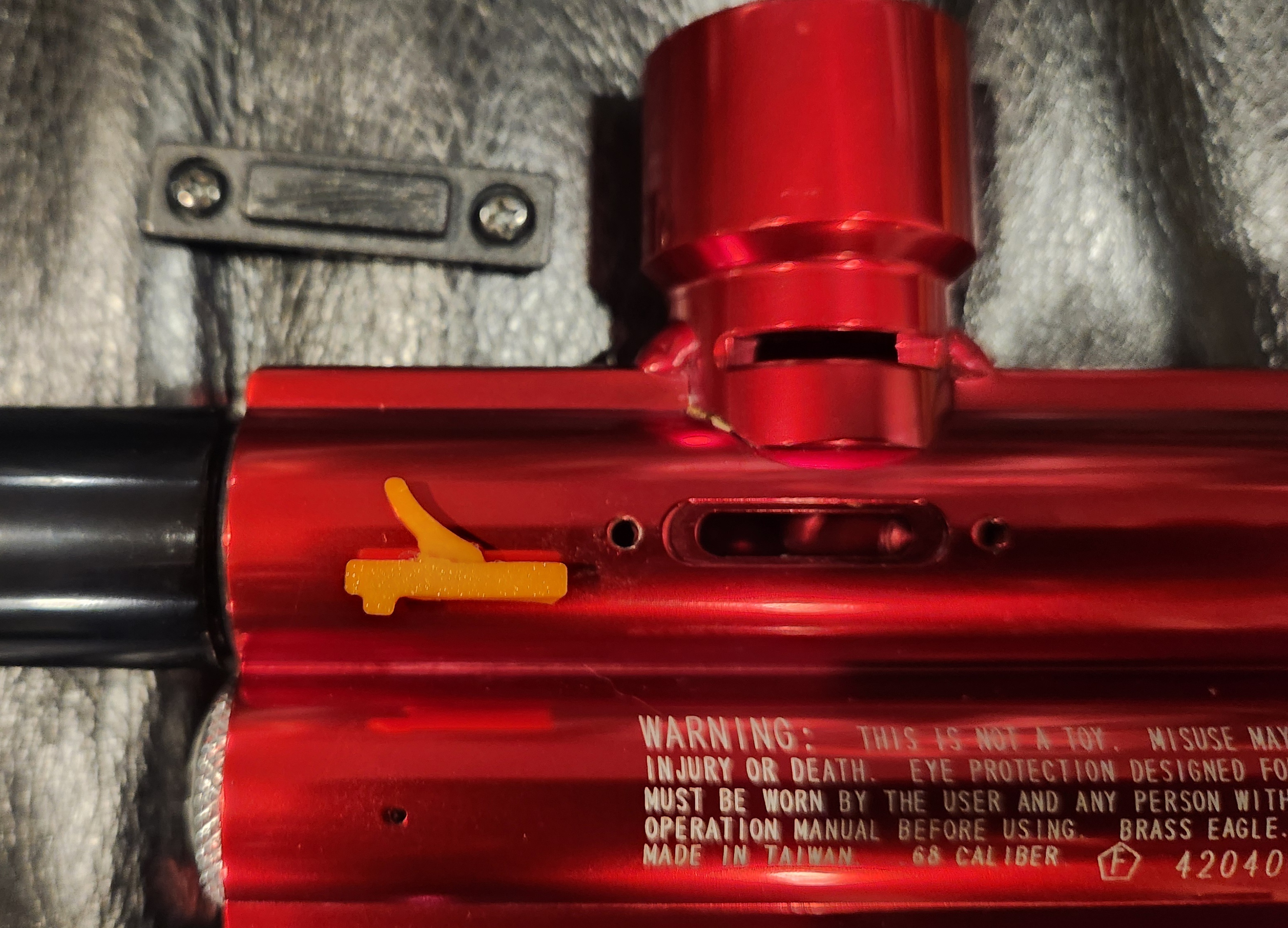

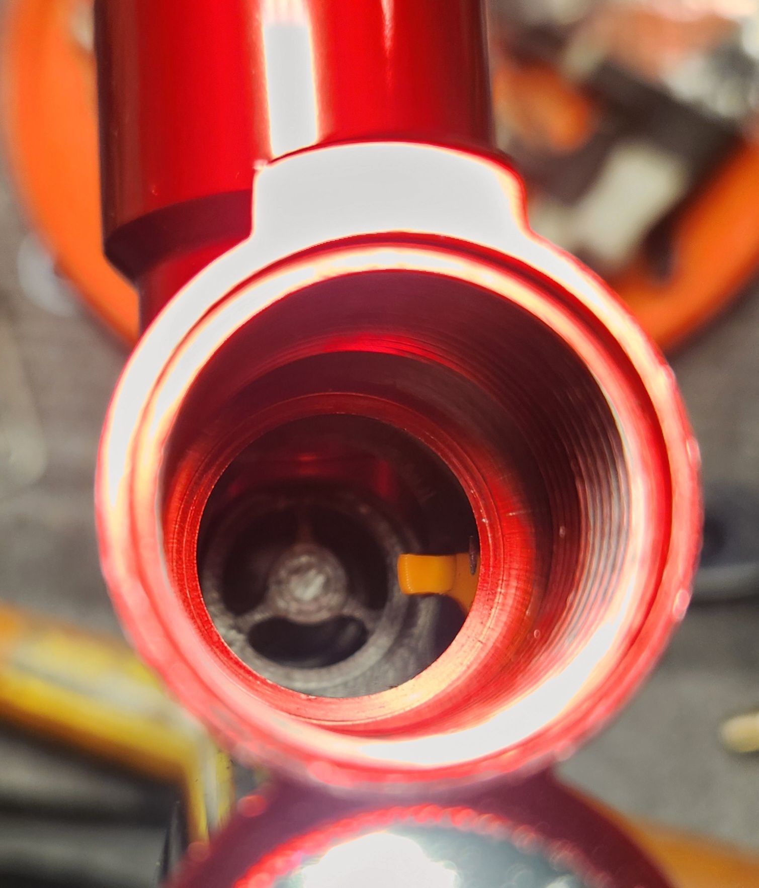

    I got a bunch of shitty Spyder clones in a Goodwill auction that included what I actually wanted. All were complete crap, but a Brass Eagle Avenger 1 was in good enough shape that I couldnt throw it out. As I am a masochist, I made a new bolt for it, and just finished making detents for it. If anyone needs this style of detent, let me know and I will send you some.

    Those look like 98 custom detents. They sit in the bottom and not the side.
    • Calvin
      Old n' Quick
      • Sep 2025
      • 486
      Its very similar in the finger. They are an entirely different shape in the block. It has a small extension on the bottom that locks into the detent cover. There was a JT Stealth in that batch that used the same detent, so I know Brass Eagle wasnt the only one using them.

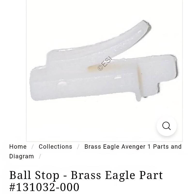

      It is this part. The original allowed the ball to roll forward 1/4", which is a negative trait. I positioned my finger to stop the ball at the forward point of the drop diameter.
        • 4509
        Very clever. Nice work man
