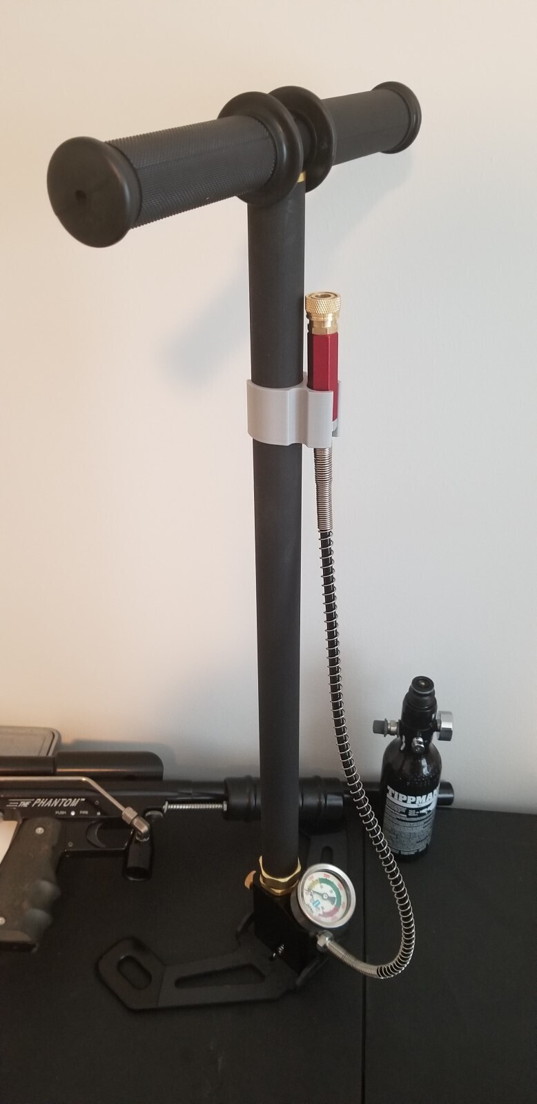

    I'm running a VSC phantom now with the factory springs. Well I haven't played in very cold weather I've had no problem using both CO2 and HPA without having to swap springs. I've got a 9CI / 3000PSI tank that works well and should provide around 150 shots per fill, also use it off the VSC ASA as you mentioned. If you play outlaw where access to HPA may be a problem, I picked up a manual HPA pump (like a high pressure bike tire pump) that will fill a 9CI tank with a few minutes of pumping. Takes a little bit of work but not bad at all if you just top it off every couple games. Not sure about feed options but your best bet is to get a stock class body and feed tube, however with the acid wash anno it may be a little difficult to source a match. I've seen quite a few people freak bore their stock CCI barrels without issue and only recall one incident where the bore was oversized and it cause the barrel to crack during play. I'd say as long as it goes to a reputable shop it should be fine, preferably someone with experience freak boring barrels.

      That pump is neat! Any chance you have a link where to buy one? + Curious where you get the fill nipple adapter.

      Loophole,
      Pump is off Amazon, HIRAM brand. Fill adapter comes with the pump so no additional purchases necessary.
      https://www.amazon.com/gp/product/B0...0?ie=UTF8&th=1
