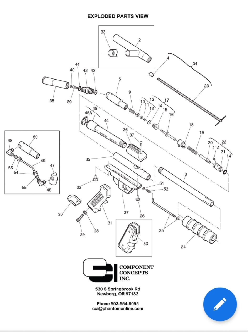

    #9 is the valve spring.
    #19 is the hammer spring.
    What kind of Phantom setup are you rocking? Pictures always help!
    Last edited by Bang*Bang**; 08-16-2020, 07:24 PM. Reason: edited to correct the note about the coloured springs being HAMMER springs, NOT valve springs.

          The colored springs are main springs, not for the valve. Silver is standard, red is +15% strength, blue is -15% strength. Changing main spring affects velocity and is necessary if you cannot reach playable velocity through adjusting the TPC alone.
          • Bang*Bang**
            Bang*Bang** commented
            My bad. Thank you for the correction!
