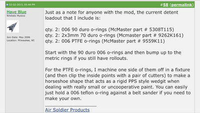

                Thought this may come in handy so I took a screen shot a few years back....
                McMaster Links:
