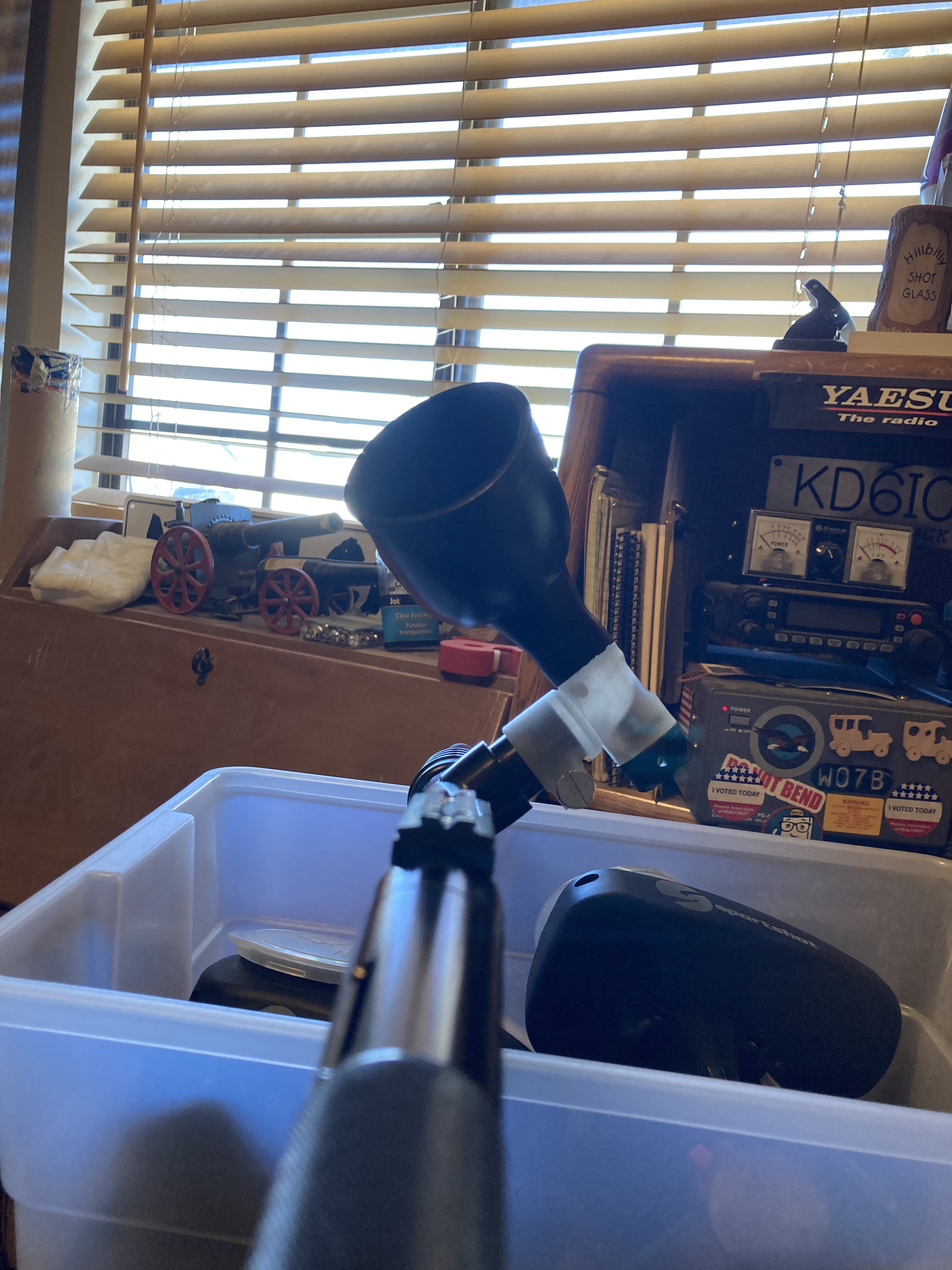

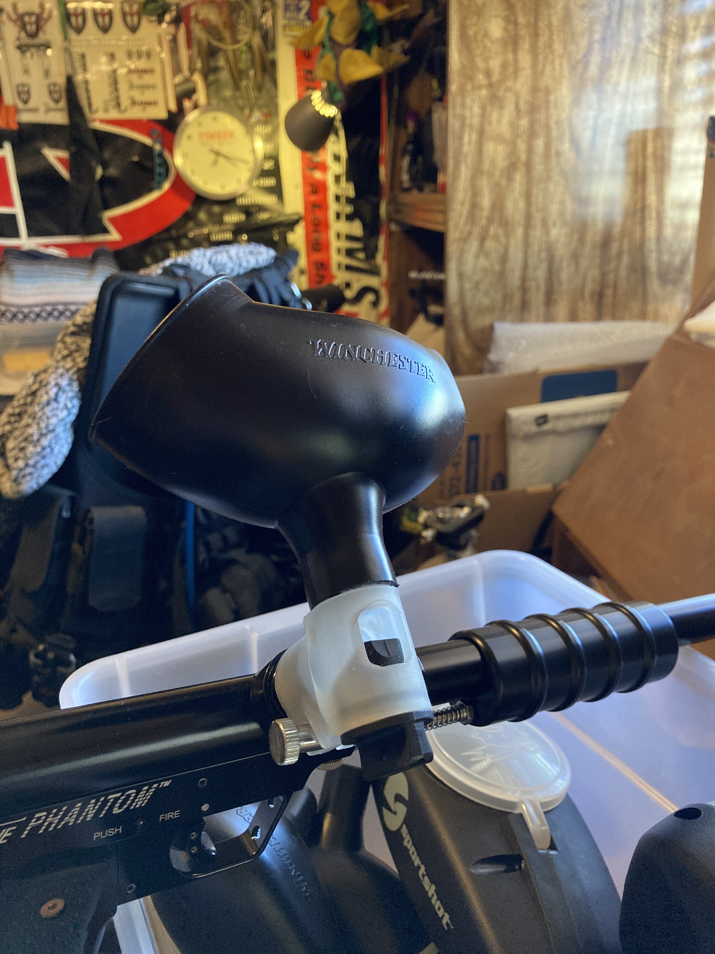

ID:	231289 I'm a lefty also and like the rt offset. Here is the setup I ran for use with a Winchester hopper. Low profile but nice sight picture with left eye dominate.
    Granted this is an open class body.
      This is so wonky, I love it!
