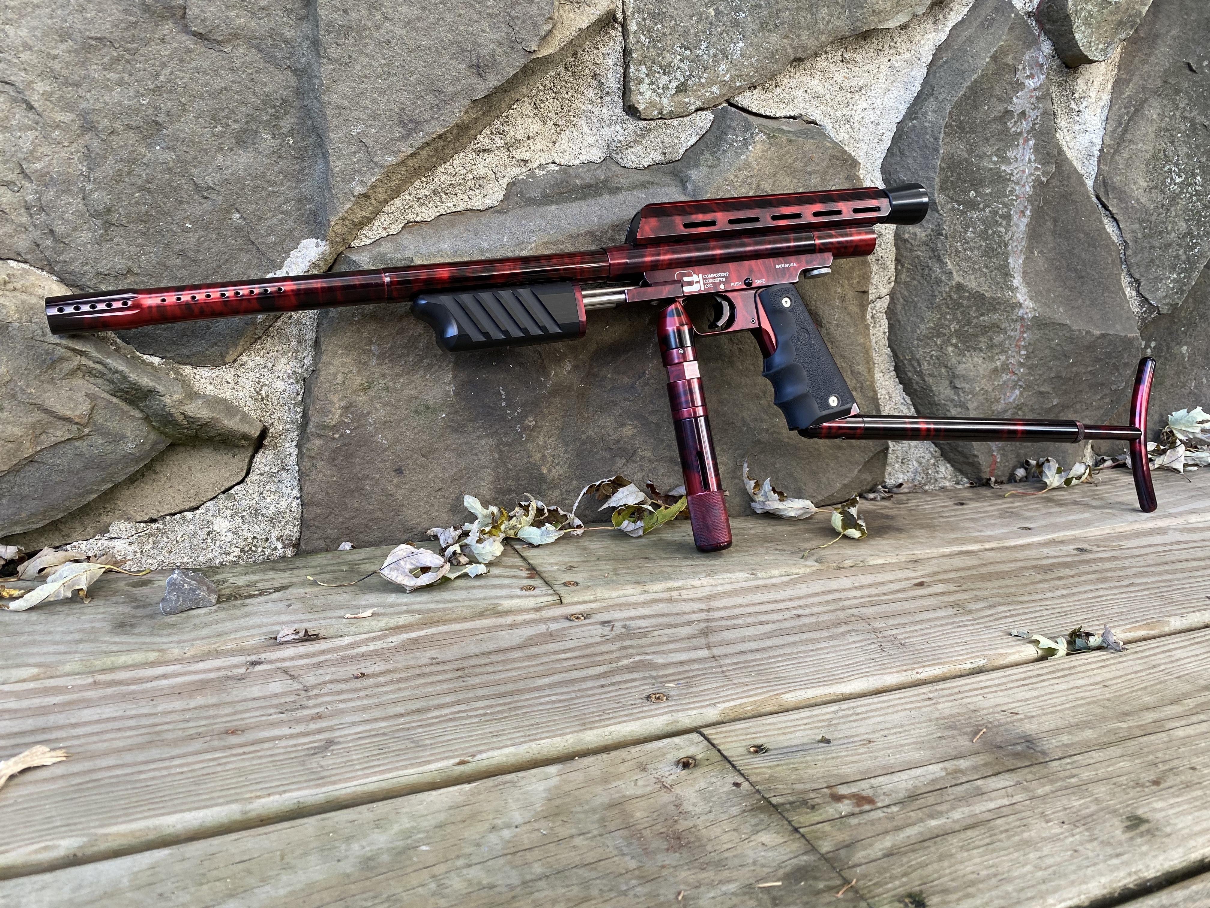

            So CCI made an inline reg. It was designed for the CCI Revolution that used lower operating pressure. Some added them to there phantom builds. I purchased this one with a matching reg and it’s really just wide open at its higher side of its adjustment range. It will help with spikes in higher temperatures or if the marker sits in the sun with a 12g in it. That’s about it most of the time when shooting its going to be on the lower side just acting as a pass threw. CCI regs are not super easy to adjust. They are more of a set it and forget it. As for performance it will very based on style, temp, and speed at which you shoot. I get the same consistency and shots to a 12g out of a regulated Phantom as I do unregulated.
            Tuning for low pressure will make the phantom a lil more quiet at the same time hurts efficiency. Valve need to stay open longer to get velocity with lower pressure so you take a small hit on efficiency. Its just not worth it. Phantom is perfect just the way it is performance wise. Nothing you do will change performance dramatically that you will see in real world play.

              Beautiful color on that
              Thanks, I found it as New Old Stock sitting on a shelf in NC still listed at the original Phantom prices before they went up. Red and black are my favorite colors. It was meant to be. They even had a matching phantom threaded Dye UL that’s on it. The stock I got from a member here but matches very well.
