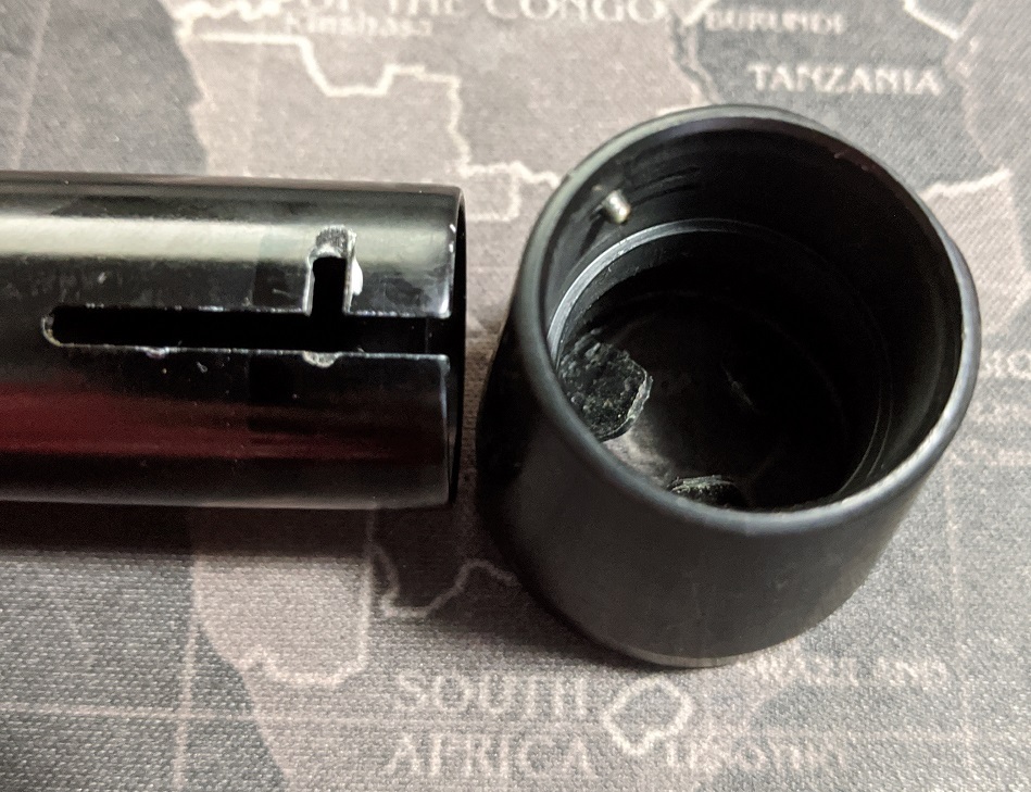

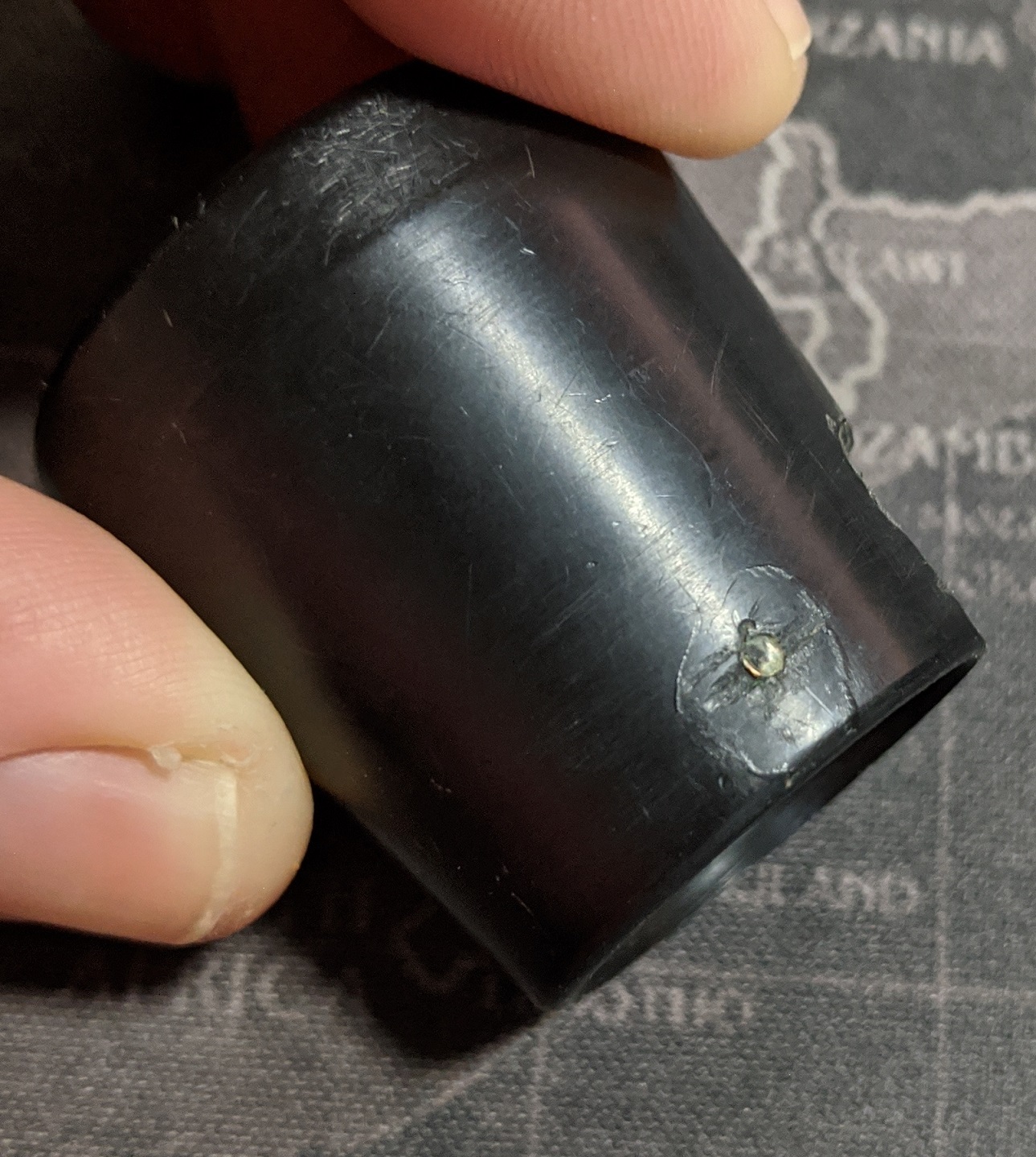

        Am I the online one that hates the OEM phantom feed cap? That thing slides off at the worst times... I modified every one of mine to have a spring pin or three pressed into the plastic and a notch or three in the feed tube so the cap can have some mechanical retention.

            Here's the easiest one. Dremel tool cutoff wheel to add the extra slot in the feedtube, and I think that's a piece of coat hanger wire or something I had laying around to make a pin out of. That was then superglued or epoxied to the feed cap, then cut flush with the outer surface and trimmed to length internally.

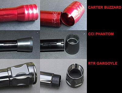

              The ones RTR made were either to be threaded onto a feed tube or friction fit inside the feed tube of a Nelly. You might be able to get him to make what you want though.

                There was a guy on MCB V2 years ago that made nicely milled and anodized ones that were slip fit like the stock CCI ones but sadly their info is gone ....been looking for years to find it,I think it may have been deleted years ago. They were milled similar to the RTR Gargoyle ones but weren't threaded.
