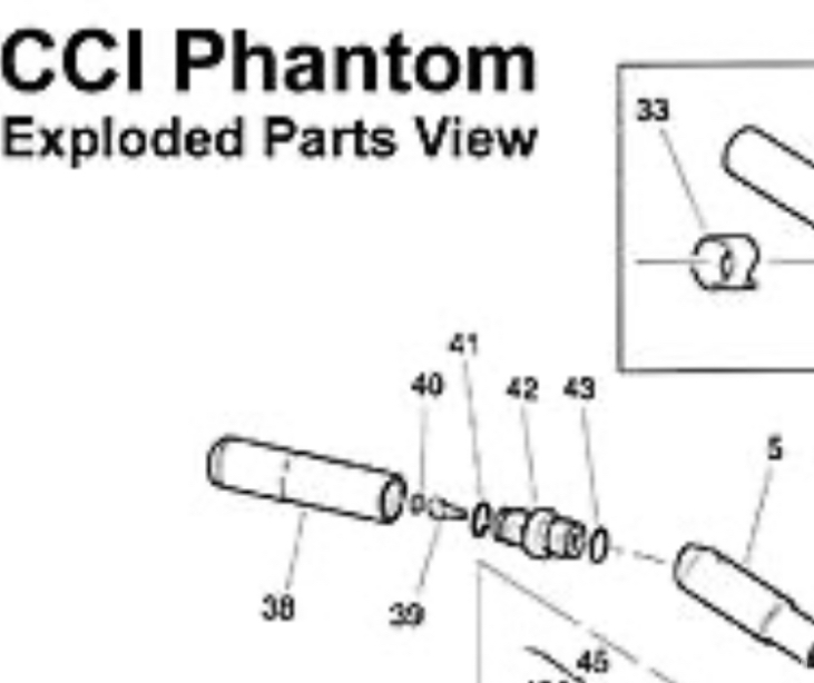

    Piercer Seals
    Seems like even my spares might be too old/ OD just small enough they keep falling out. Getting leaks. Dont wanna pay EV $5 for one seal. anybody know where to buy a bag for cheap? or should i buy a rod of urethane and cut my own? anyone hip to the size?
    part No.40

    even though this tutorial is for a splatmaster, you can apply it to anything
    Make a 12 gram seal for the splatmaster in 10 minutes with some basic tools. 1/2" delrin rod from amazon $20 1/8" drill bit Hand drill Hacksaw file Vise grips or pliers Calipers or some other measuring tool vise/clamp just make the seal wide enough to press tightly into the valve body. I find this to be around
    • $L!mBo
      $L!mBo commented
      thank you sir!!
