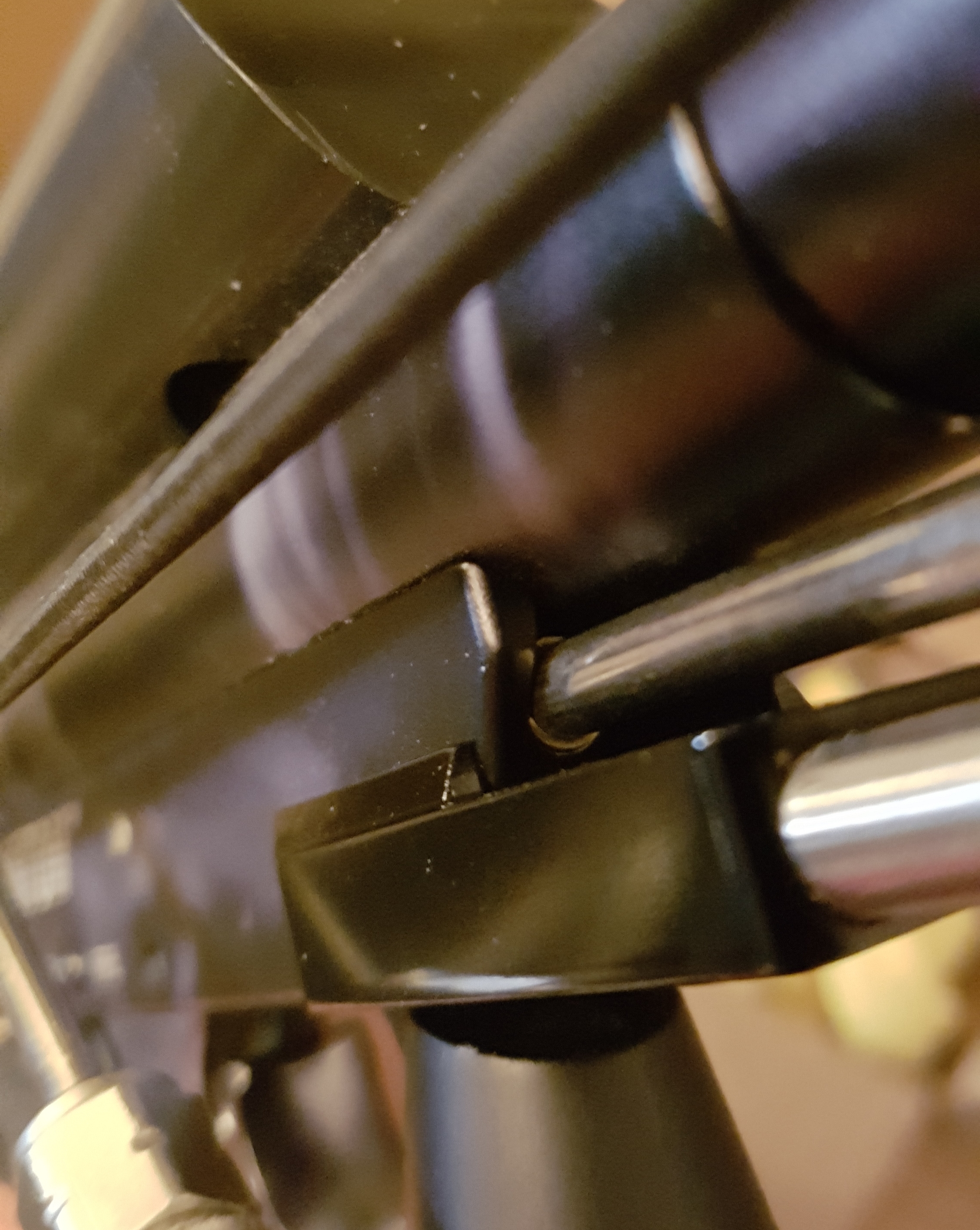

                      This is another thing I'm new to, what do the pump shims do and where do they go?
                      • BigRed
                        • 1060
                        • Canada
                        They take the little bit of wiggle out of the pump arm. It's a small brass tube that you put on the pump rod then sits in the milled out groove in the body. It fits very snug in the body and doesn't move but guides the rod without any slop. You can see it in the picture below.

                          iamthelazerviking commented
                          HmMm did you have a hard time getting that in? I will have to play with it more but mine seems to get pinched and then the rod won't move
                        • BigRed
                          BigRed commented
                          Once I had it on the rod and the pump kit back together it was a firm press into the slot from above. I didn't slide it in from the front...not sure if that is what you did.
                          BigRed (not sure if tagging works haha)
                          Yeah, I pressed it in from above. Just seems like the slot is too tight for the shim so it pinches it and prevents the rod from moving.
