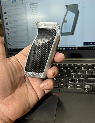

                I had the same problem with unattainable ccm grips so I’m making these.. currently just fine tuning fit
                • Frmrspec
                  Frmrspec commented
                  Honestly… no clue. The ccm grips I have fit great. I’m currently fine tuning fit for CZ75 hogue grips
                • Have Blue
                  Have Blue commented
                  Nice, will you be selling these?
                • Moodog
                  Moodog commented
                  You planning on selling these once your design is finalized?
