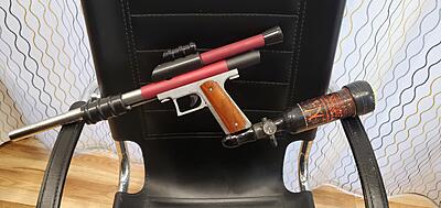

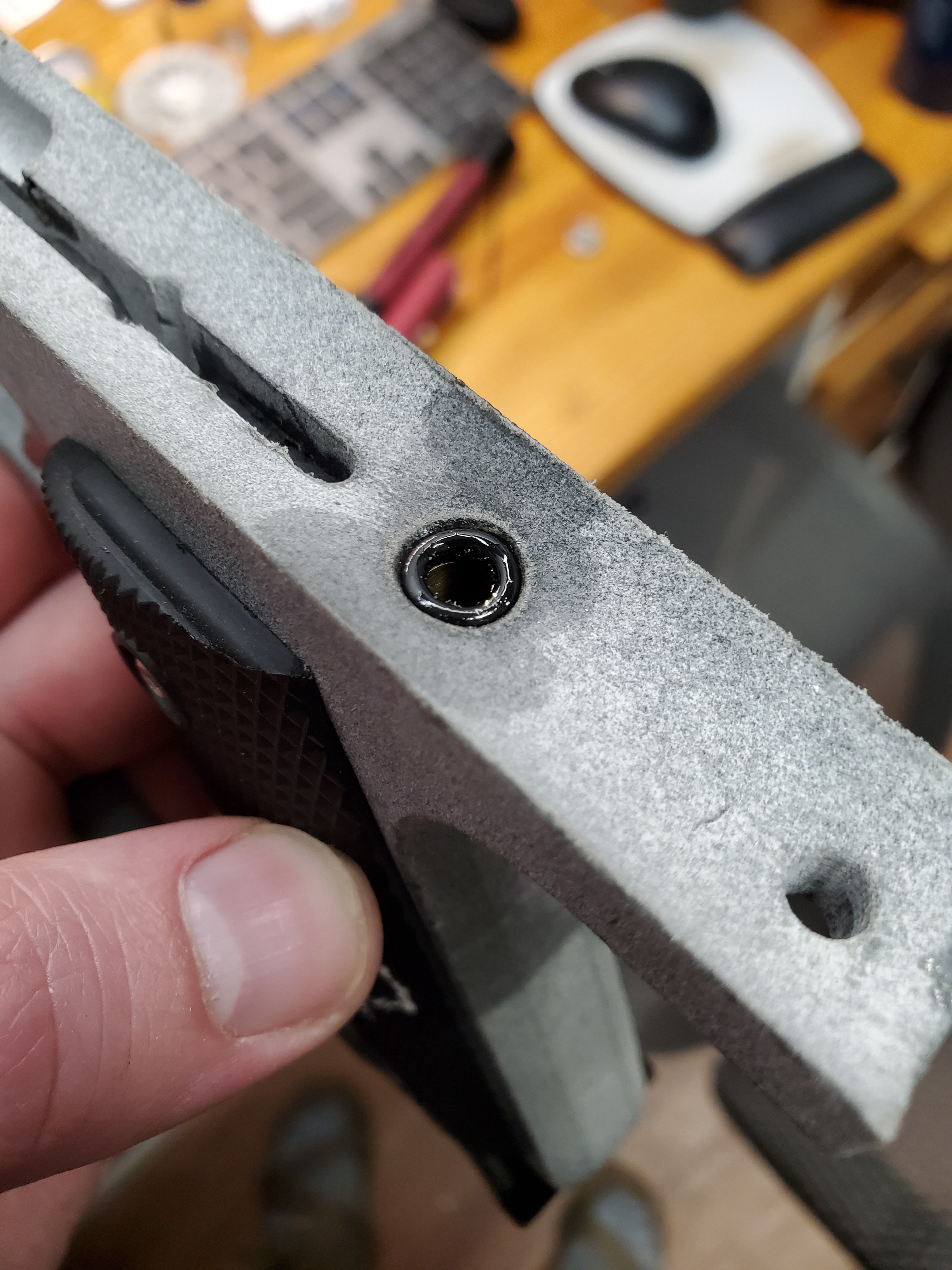

    I made a printed prototype of a frame. With the Phantom 2.0 being a bit of a bust, I decided to take another go at it. Still wondering if I should pressure-test this one, or if it's better to wait for one in aluminum.
    If nothing else, I made a frame that has a proper radius for my thumb web, and takes standard 1911 grips instead of having holes that are 0.040" too close together. I'm calling it a win either way!
    Off to do some math.

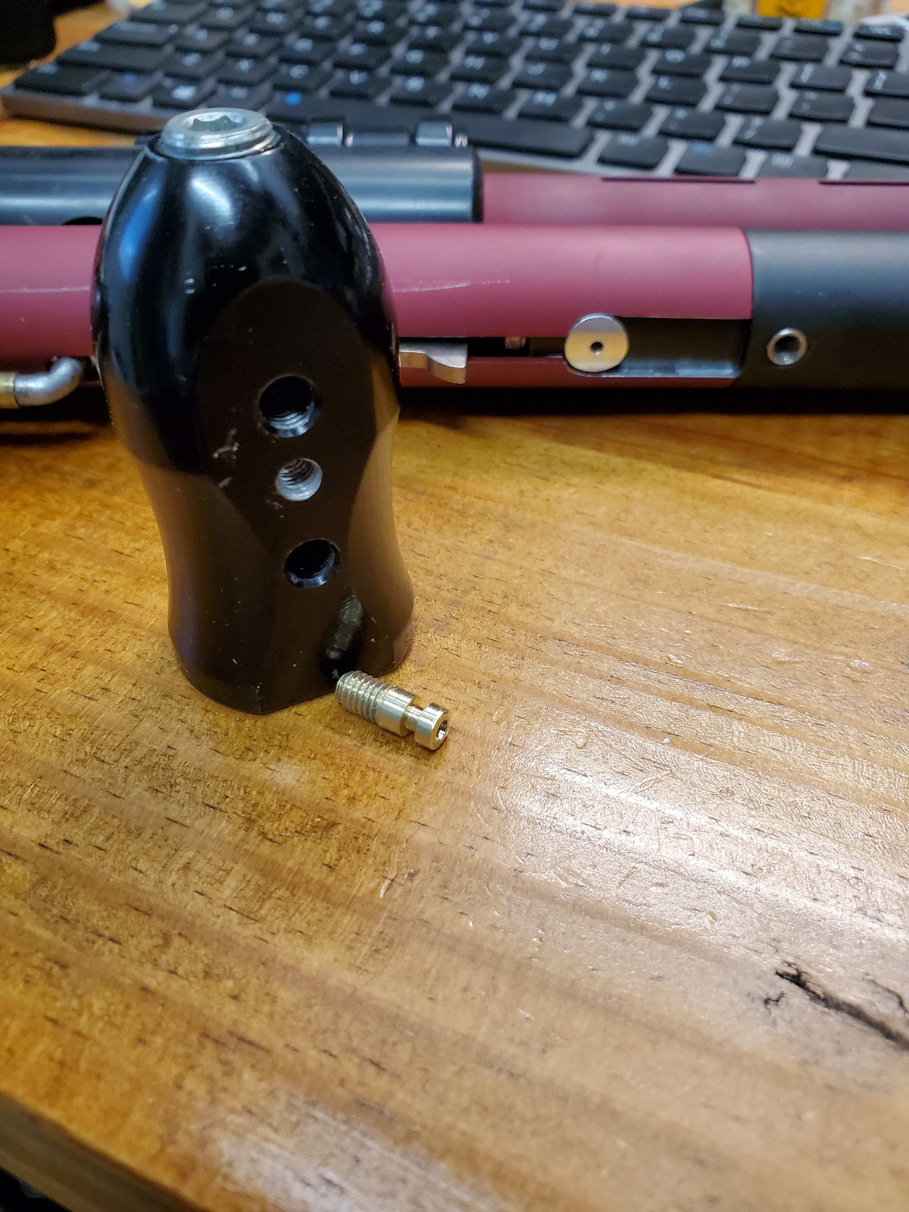

    Update - with all the speed of trying to design around small children.
    Pretty easy to mod a CP ASA to put gas into the frame. It's a single o-ring on a nipple.
    The valve, I went a little fancier. I added a boss for the frame to seal against, under the idea that it would still be easy to field strip without undoing the front screw. It leaks on the current, printed version but I think aluminum will be quite a bit smoother. Maybe some silicone glue on the gland face will cover the little cracks so I can field test it. I think a nipple will be more robust, but it would require dropping the whole frame to remove the valve.
    I'm thinking of running a VASA hose through the trigger guard into the internal gas line but that's probably a phase 2 thing.
    • flyweightnate
      flyweightnate commented
      Swapping the -005 for a 4mmx2mm fixed that leak nicely.
