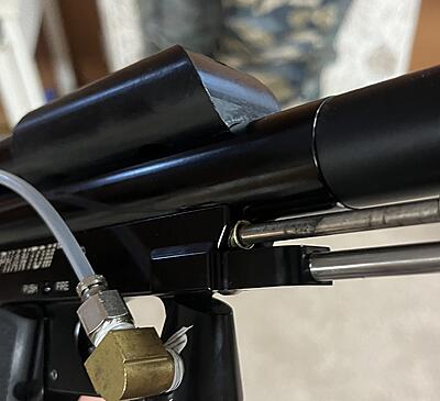

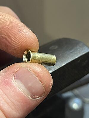

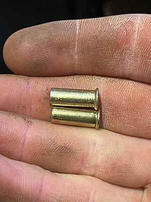

    I remember seeing a thread here years ago about how you could use 22 caliber shell casings to get rid on the slop in the pump arm channel in the trigger frame. Ordered some spent casings and went smoothly with the proper tools.
    Works very well, makes a noticeable difference in the pump stroke, no more side to side or up down play in the pump arm, and I'd imagine the brass will just get smoother over time. Now I'm gonna have to make some more for my other phantoms

    I've also used the tubing inserts from ferrule fittings.

          If you combo a flared shell casing like that with the factory spring and the nylon washer it makes for a tidy improvement to some minor imperfections in the original design. I use this on my “Micro” Phantom with super short barrel and pump handle since it needs it even more than most. The result is pretty much zero slop or twist. With the dual rod undercocker they are irrelevant.
