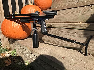

          Boy I hope mine looks that good with the 9ci sticking off of it! (not sarcasm)

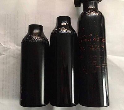

          • 6380
          You should get that no problem! you could always get the 10ci for a lil more.
          I get 150 shots @280fps on a hot fill 9ci
          Tank reg is set to 825psi
          Clean lightly oiled CCI Phantom
          stock silver spring (valve & hammer)
          14” freak bore
          Good paint to bore match just barely rolls threw. (I let the ASP detents do there job)
          9ci>10ci>13ci
