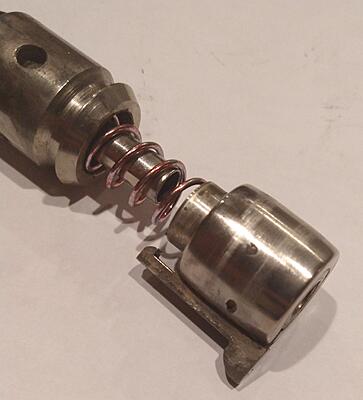

              Take some pictures of the internals and what you’re working with.
              Is the pump arm orientated in the proper spot?
              What does the sear look like?
              Check the engagement points on the bolt like the sear dose it look like it’s engaging properly. It should be pretty much a right angle and catch on the back lip of the bolt.
              Is your pump arm screwed to far in try backing it out a bit see if that helps.
              Make sure your the brass piece on the cup seal is orientated properly and that your Cup Seal is tight. Try flipping it over see if that helps.

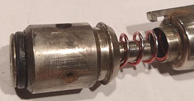

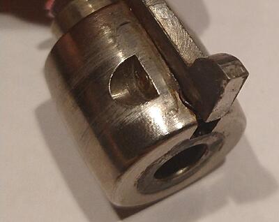

              • VintageZoomer
                VintageZoomer commented
                Posted pics below..
                The pump arm is connected for sure.
                The sear was hard to capture, maybe a little silvery but not terribly worn.
                I just tried backing off the pump arm a bit, but no change resulted from it.
                I posted both sides of the cup seal, either side saw the same velocity issues.
                Everything fits tightly and with tightened screws, I triple checked this per your and Jeep's suggestion.
                It's a screw driver TPC.

                    If the cup seal was loose that’s your issue. 1.5 turns in from flush in on the TPC put the silver spring in it. That should put you super close over the chrono 280 ish with a good bore match.
                    Internals look good back your Pump arm out a few turns. Re set that nut or remove it (I take them off) it’s impossible to move on you when the barrel is installed.
                    If that grease in the trigger frame wipe it clean as you can use a few drops of oil. (No grease) lightly oil just enough to make it look wet. I like to polish up the contact points but it’s not necessary just insure they are clean. The sear slot need to be free of anything that will slow the hammer down on it rearward strike of the valve face, otherwise it will be super inconsistent and need more spring to do it job properly. Make sure that channel is clean and lightly oiled.

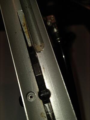

                      Is your sear slot in the trigger frame wonky? The narrow bit between the pump arm slot and trigger slot looks rolled over. It might be grabbing the sear. Maybe file it smooth and flat.
                      • VintageZoomer
                        I noticed that this morning, it was definitely causing some binding. Bent it back out and sanded smooth, but no change in behavior.

                      The cup seal is now completely shot...leaks down the barrel using either side.
                      Do I order a new hammer while I'm buying a new cup seal? I'm running out of ideas/patience with this thing.

                        It looks like you've got an old style sear on a new style hammer, or at least it looks very familiar to the one in What2007s thread. I'll have to double check when I get home, but I'll see if there are any issues with clearances/tolerances between the different styles.
                        If you get tired of messing with it and don't mind shipping it, I would gladly take a look for you.
