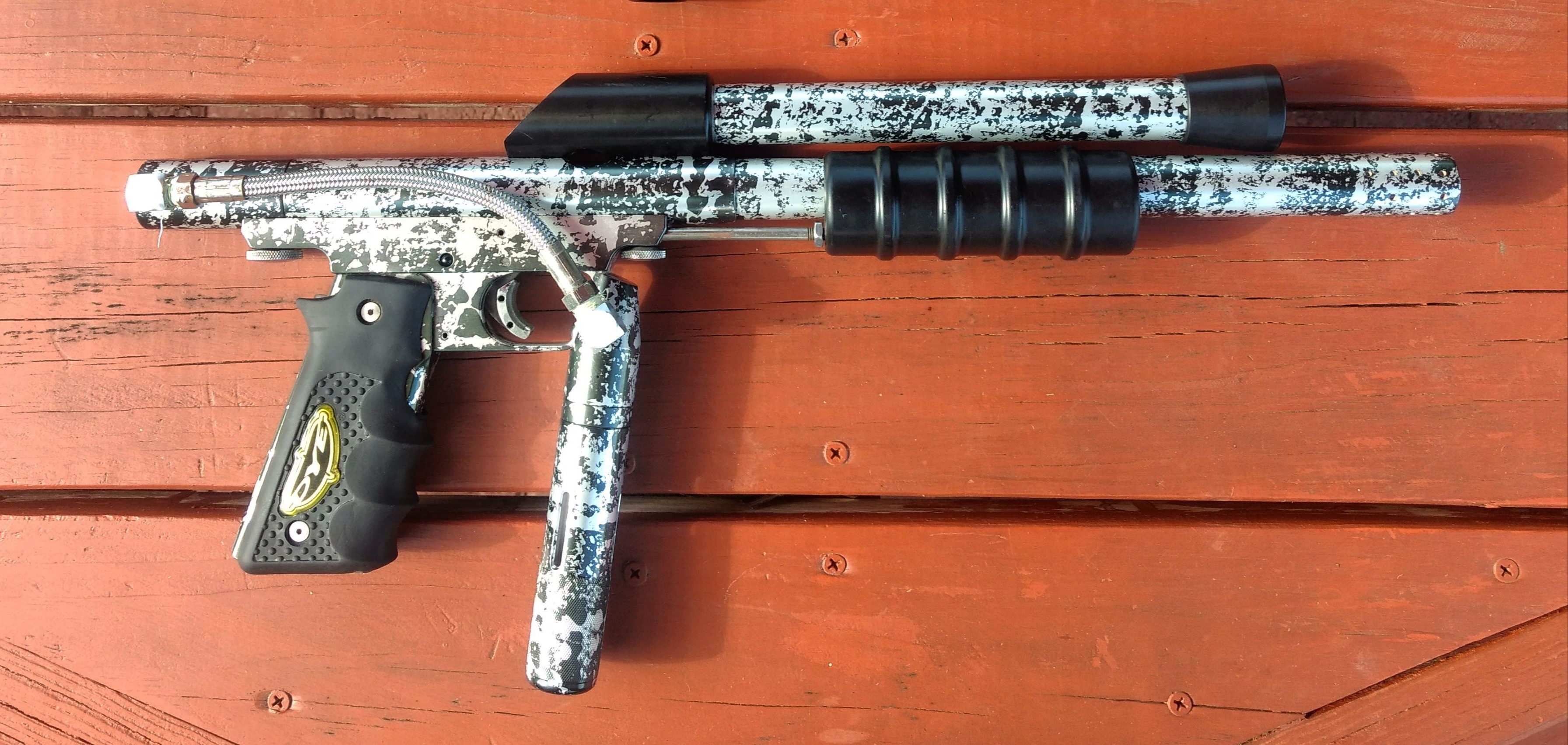

      20201126_102241.jpg I believe this is what he is going for. Some people's preferences are to rock back he may be used to Sheridans or just more comfortable rocking back it does help out with double feeds
      V.P. of Ragnastock
        JeepDVLZ45 commented
        Yes, this is what I’m looking to do.
        I have played with pumps a few times in the past — it’s been a LONG time...I honestly don’t even remember what they were...it’s been 20+ years.

      Ah, so it actually does leave enough for the pump handle. It does look...way too easy to break though.
      • Flounder
        Flounder commented
        No easier than the standard style feed block.

        My reverse feed (the one Havoc posted) is working great as it is a solid chunk of delrin like the normal sc feed block. I have two broken Apoc feeds in my trash bin, though.
        From actual experience, it doesn't take any more time to rock back as it does to rock forward as you say it does. I see people say it all the time when reverse feeds come up but I'm convinced it's cause those people have never actually used one. If anything I am faster with my reverse fed Phantoms as I never have to worry about smacking my mask with a 15 round feed.
