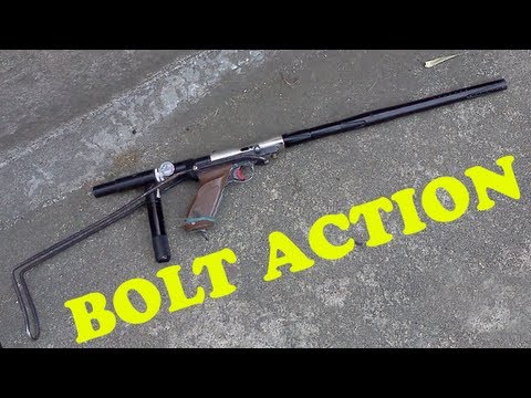

              I had great luck using my bolt action SNY commando with a PPS Stabilizer. Can't find any pictures left over from MCB 2.0 but I've got a video here.
              I ran the Stab at the upper range of its adjustment, probably around 700 psi. That stops spiking and improves consistency. The other thing I did was add a choke after the regulator to limit its flow and recharge rate. That stops liquid CO2 from bypassing the regulator and expanding afterwards.

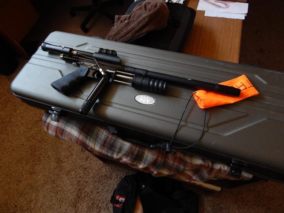

                          I put CCI regs on almost all my Phantoms. Can't really tell that it improves anything other than giving me a mental edge that my shots are the truest.
                          Here are my reg-ed twins:
