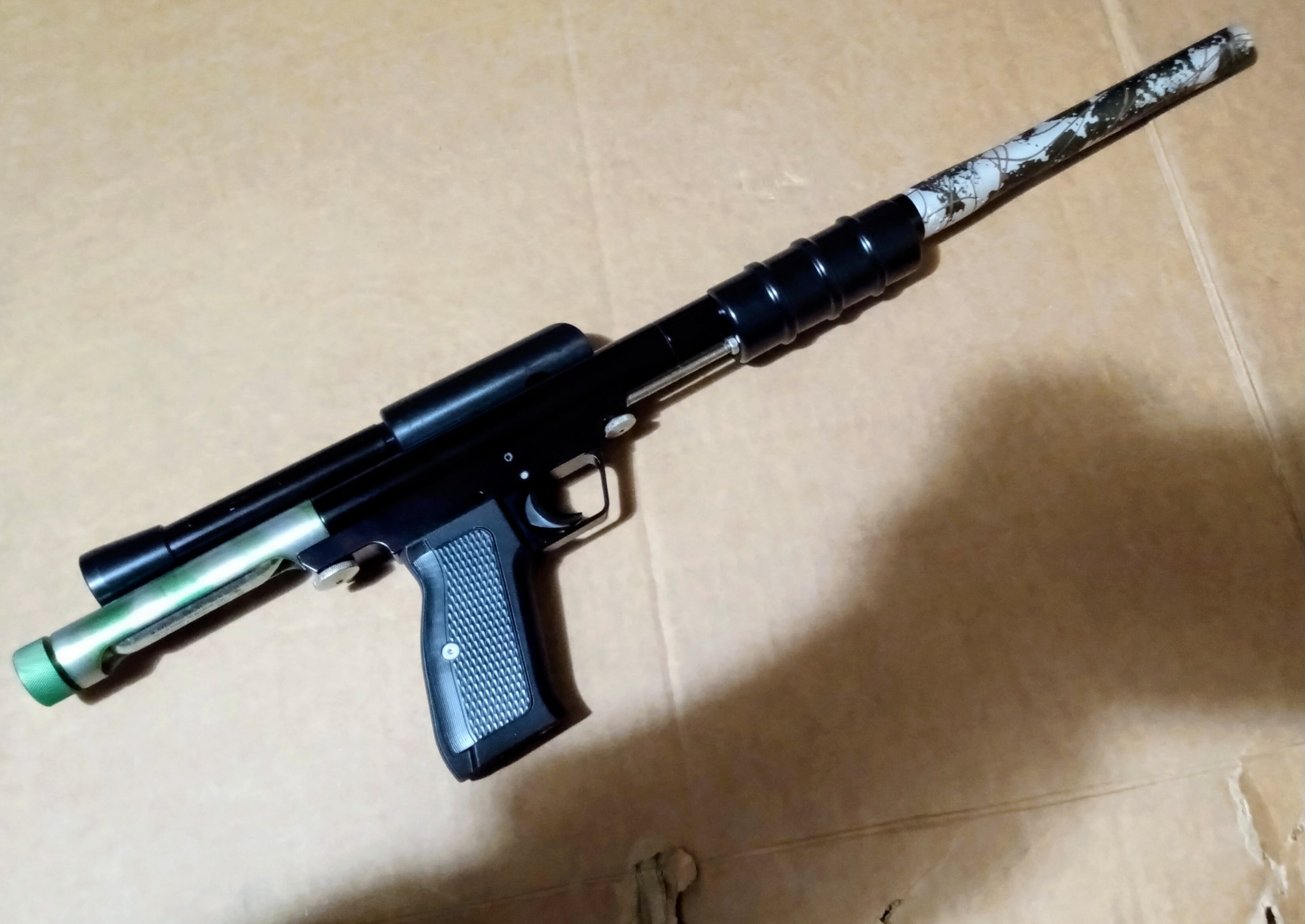

                        Here's mine.
                        I've got a 36 45 setup I can use too.
                        But it's more fun like this.
                        I've just got an old ninja reg on the 36.
