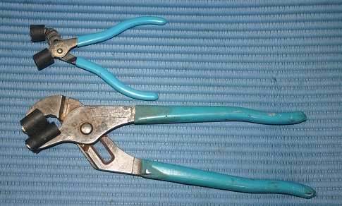

          I use Channel-Loks, and place a piece of rubber hose over the top and bottom jaws. Cut a lengthwise slit in the hose piece and they slide right over the jaws.

            Brilliant. Here I am buying soft jaws and the arched jaws rarely work for anything paintball.
