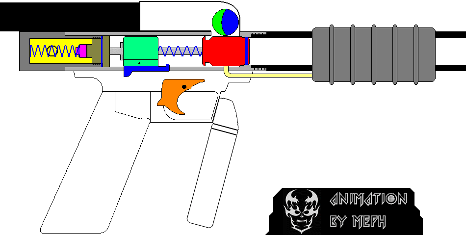

      Originally posted by XDrachen
      I never understood "bore drop vs breech drop", is that basically referencing unibody markers and markers you can remove the barrel?
      The shape of the bolt and the diameter of the tube the ball drops into are the difference. In a bore drop the ball falls into an area roughly the same diameter as the barrel, or bore. In a breech drop the ball falls into the larger diameter area of the breech and is then pushed into the necked-down diameter of the barrel. Theoretically the bore drop will be easier on paint because there's no bump to push the ball over to get it into firing position and the next ball in the stack won't intrude into the chamber and get abused by the bolt when the breech is closed. It doesn't seem to be a real world problem though. Phantoms are breech drop and are about as easy on paint as you could ask for.
      Bore drop:
      Breech drop:
