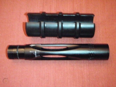

    Once upon a time, I think CCI sold stock pump handles bored for 1" barrels. Since the hole in the handle is offset from center, when its bored to 1" it creates that slot you are thinking of.

      Yeah, if it’s like the ones I’ve seen it’s just a regular handle drilled out.

        Here is a pic of your target:

        • Brandon
          Brandon commented
          That's it ! thanks

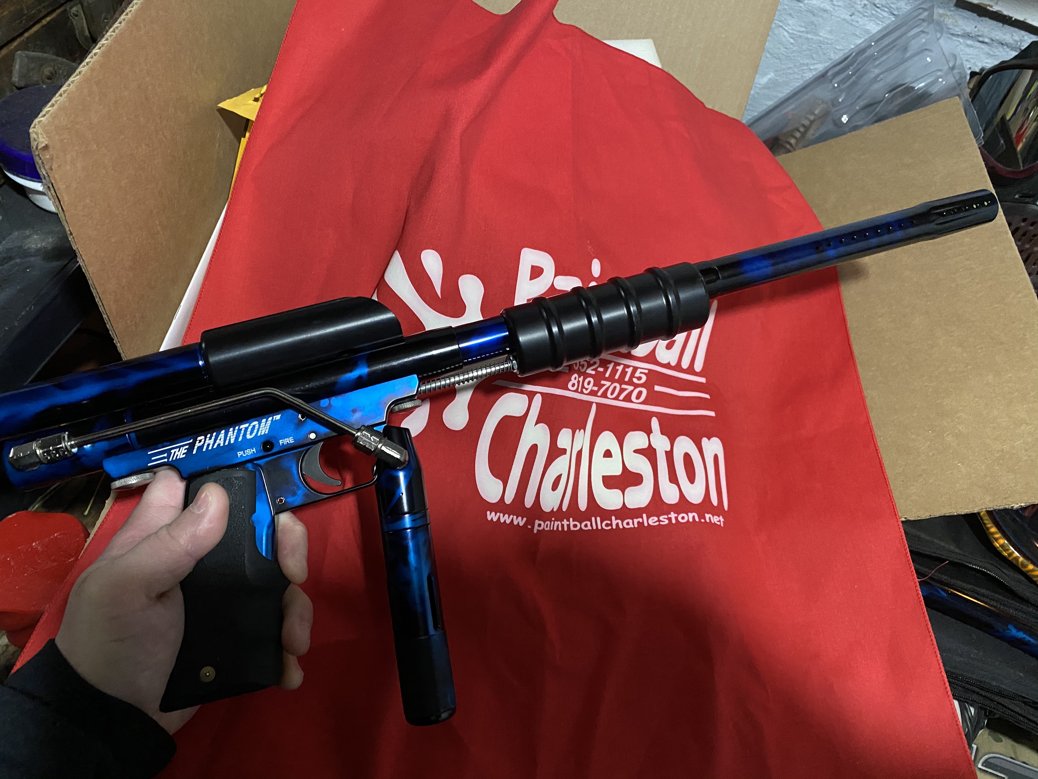

          87A59865-C0D7-478F-AE3B-E7A48B6BB76E.jpeg I don’t remember CCI makeing them. I do remember ASP making them.
          Its just a handle that is bored for a 1” OD barrel. The outside diameter of most cocker barrels.

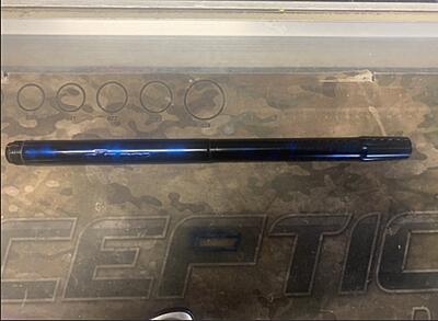

          by the time you find a round head cocker body and a handle it would be cheaper just to get a phantom threaded dye UL. It fits in the stock handle they run about $100. It’s one of the only barrels I have found I actually like better the the stock CCI barrels. It’s a really nice shooting barrel and it’s quieter then the stock barrel. Most aftermarket barrels on the phantom make it louder.

          You could also have them freak bored I have a gloss black one I run a lot that has been C bored. The threads were chopped off to remove the oring groove and it was bored and rethreaded. They are sweet barrels I run them on all my phantoms. I have a cocker threaded body and have run cocker UL barrels on my Phantom. But honestly the Phantom specific one shoots nicer and it will fit in the over barrel handle style. Definitely the way to go if you can find one.
