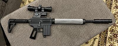

    My CCM SR1, I originally had gotten this beast back in 2016 and owned it for 5 years or so, but had to sell it when I was moving away. A few months ago I saw it posted for sale and ended up trading one of my mag builds I hadn't used in awhile for her and luckily she came with the really hard parts to potentially replace again. Will hopefully get her back on the field soon.

    At the risk of sounding dumb, where's the asa/12 gram charger?

      I see, that's a really sleek design. I was under the impression the magwell and magazine were functional, so now I have to ask, where's the feed?

      Its actually breach feed via an aluminum shell thats bore sized for paint, load the shell in the breach, rack the bolt forward, a breach sealing o ring on the bolt seals with the shell, fire and when re racking the bolt, a ball bearing acts as an ejector and the shell kicks out of the breach and you can load a new shell in. Only holds 1 shot at a time, very satisfying when you make a long range shot with first strikes, I've hit guys at over a 100 yards with this thing. There is also a lock down screw that holds the shell in place so you dont have to reload shells, just breach feed paint which is what I usually do.

      That's some truly wild shit, sounds like a really fun and well designed marker.

    So is the SSR an evolution of this that takes actual small magazines instead of the faux shells?

    Does this take any M16 grips?
    Very interesting marker!
    • Magageddon
      Magageddon commented
      Yes, pretty much most ar15 compatible parts will fit with this platform, same goes for the SSR
