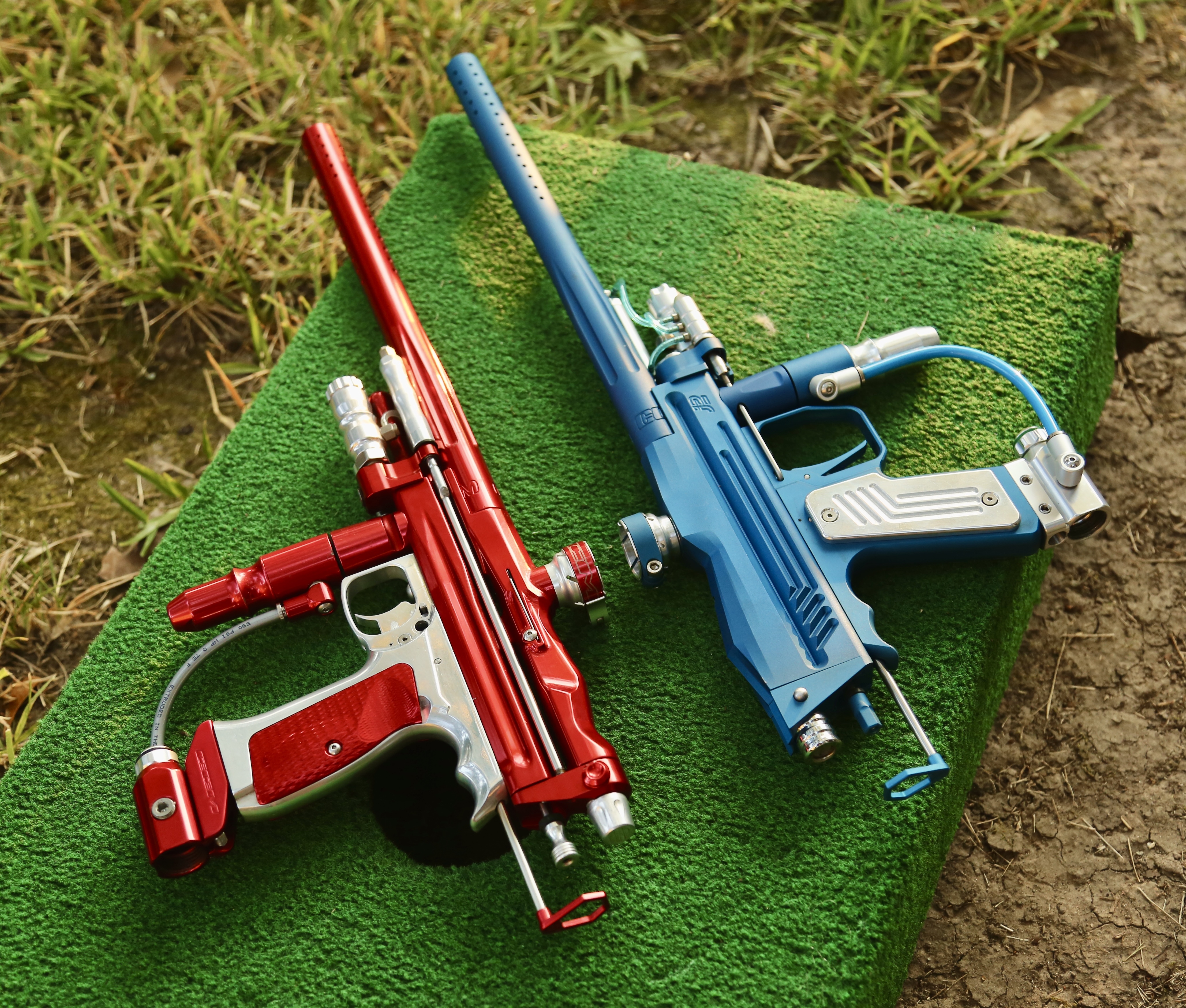

          Here are my J2s love the differences.
            Dam I want that O4 I need a mech for my J collection. With the 86* that is perfect!

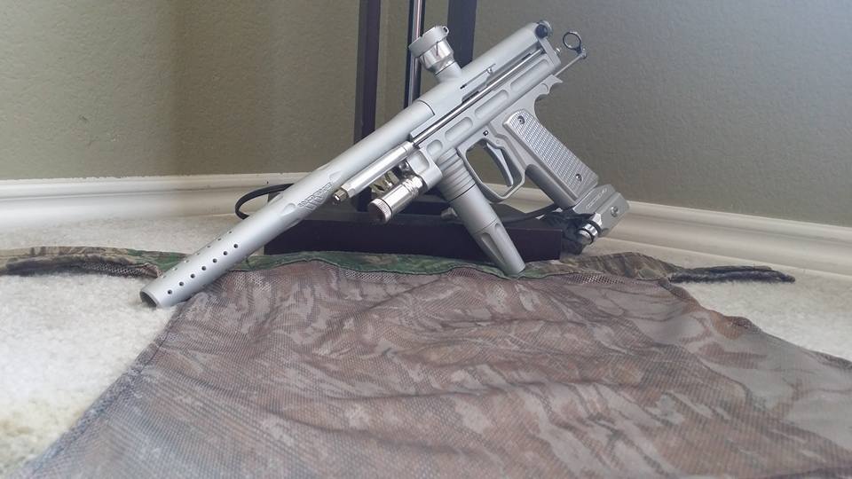

            I was told this is one of the early s6 prototypes. It was sold as a body kit from CCM to am employee working at the time paintball charleston who sold ccm markers.
            Here is a pic of an early s6 with the removable vert asa. These were machined from S5 blanks and the serial number was labeled as S5P.

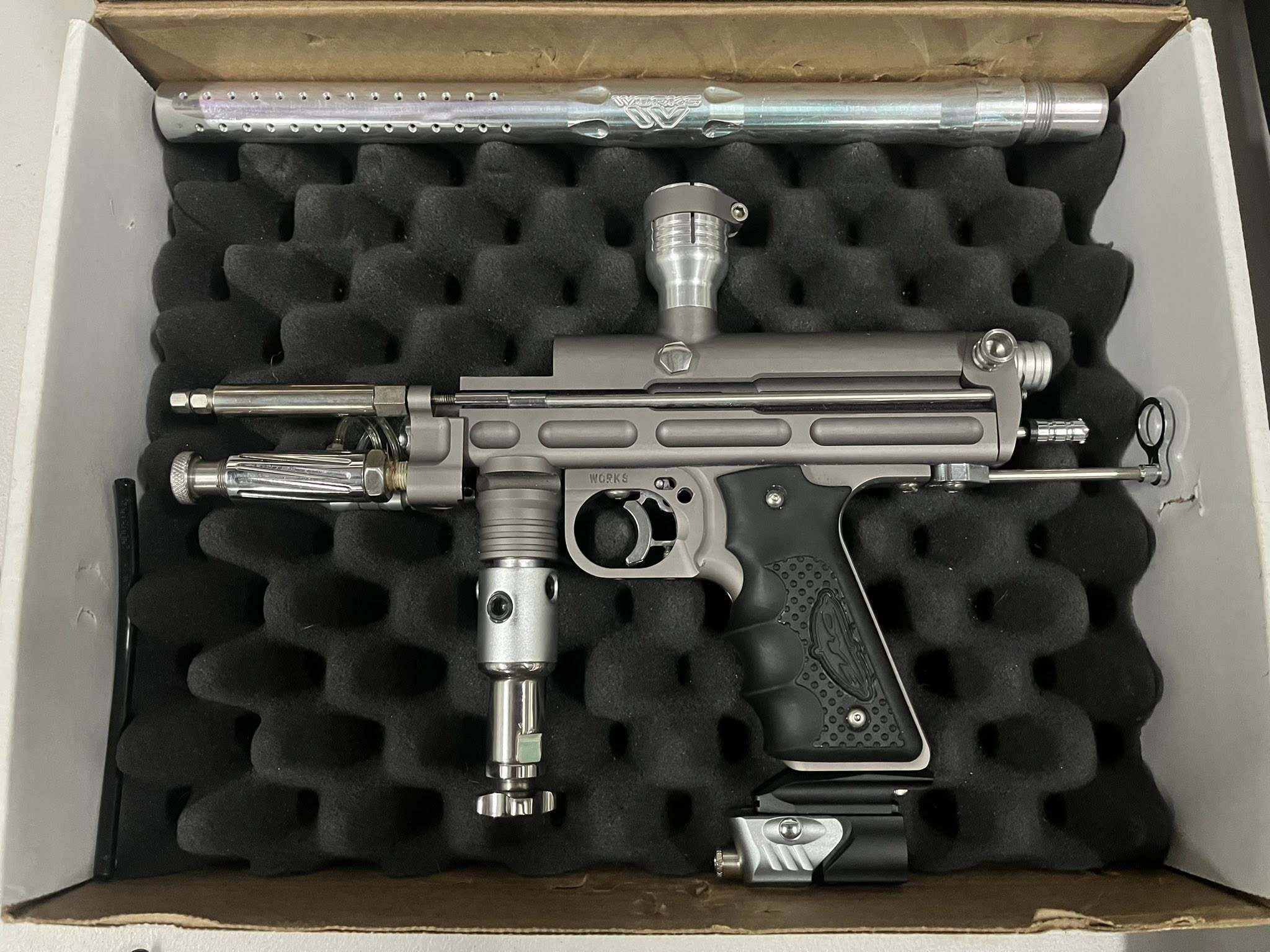

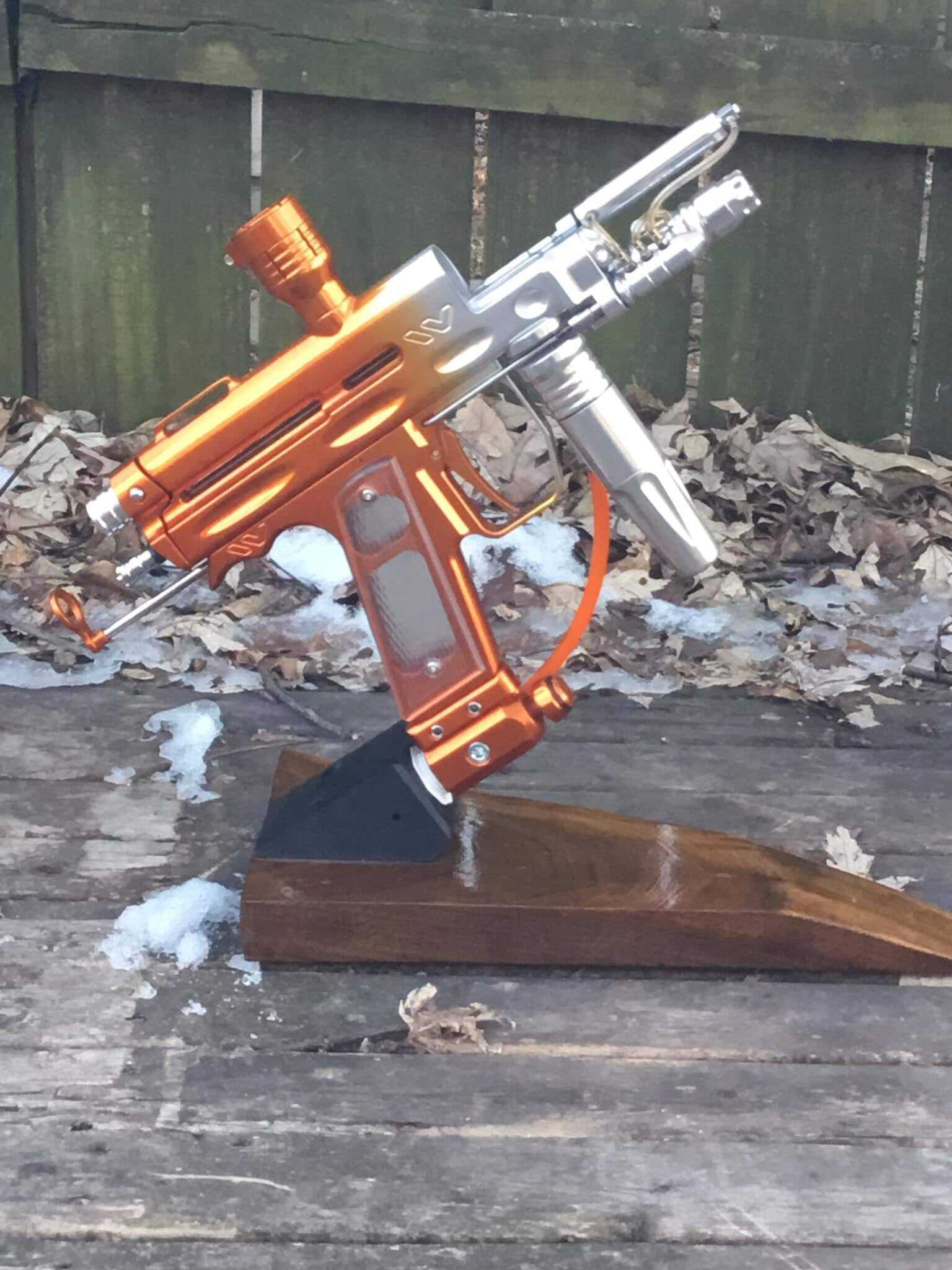

            some info on Works:

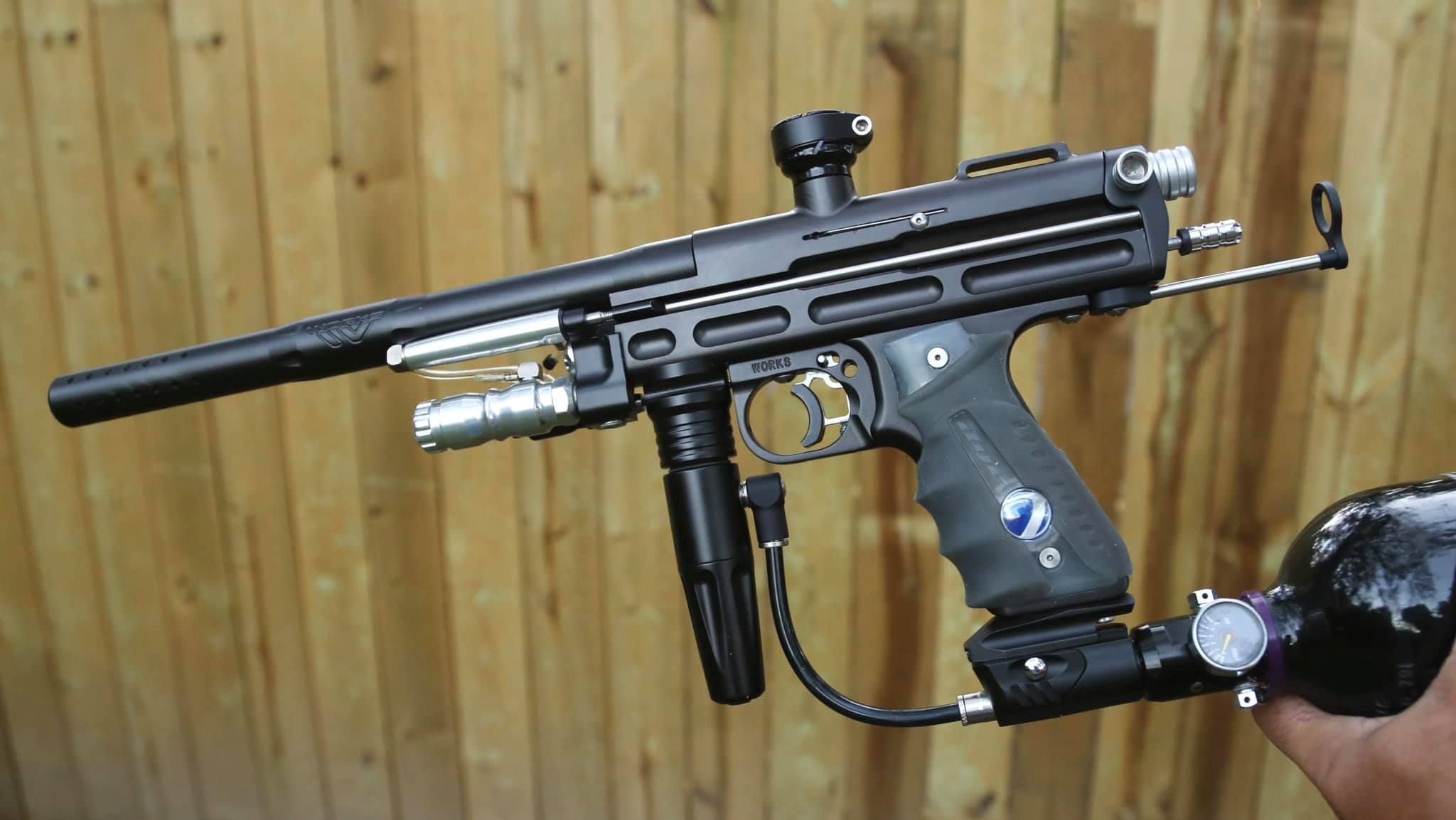

            Gen 1 works merlin bodies
            Mini and Full length versions / Three Pills on both mini and full bodies. Aluminum smooth edge merlin banjo bolt.
            “Works” branded benchmark sliders with skeleton plates. Sonic LPR / STO rams / mix of 3ways mostly STO i think?
            standard ball detents / Gen1 MacDev Gladiators / stepped ccm style pump arms / ccm drop forward style asa rails?

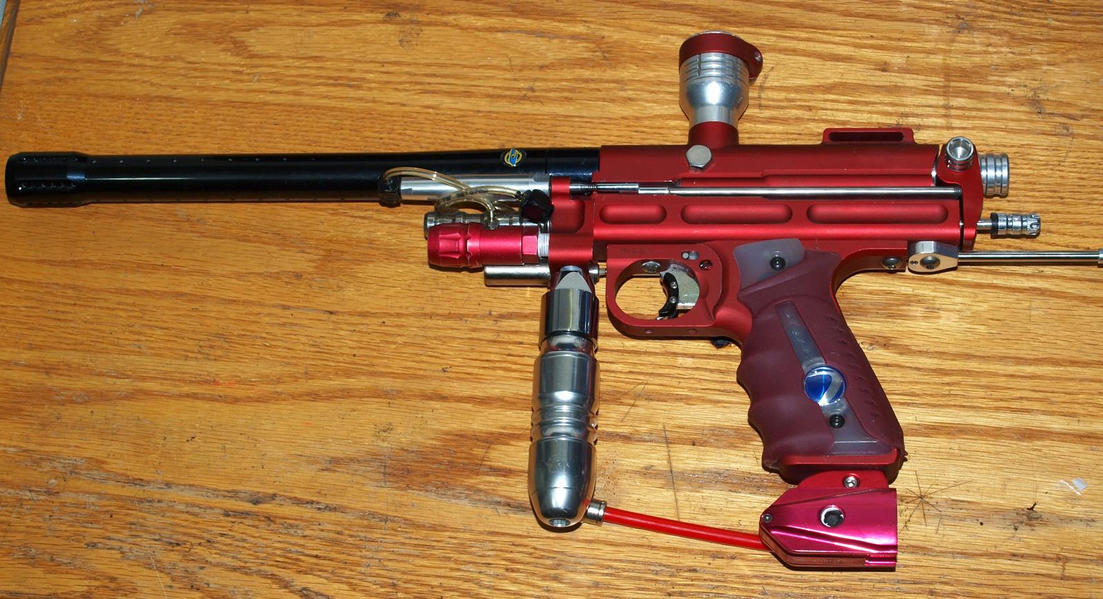

            Gen 2 works bodies
            Mostly full bodies some minis... pill shape milling (three big pills and one small pill by front block) - works branded benchmarks and ccm style 45 hinges. Works branded LPR, ccm style smooth ram, Work 3way... various configurations / “works W” branded barrels Wmiddle bulge? Wire Detents, Works milled ccm style HPRs. Some smooth on top, some with rails. Mostly P blocks / some 2k with standard back blocks.

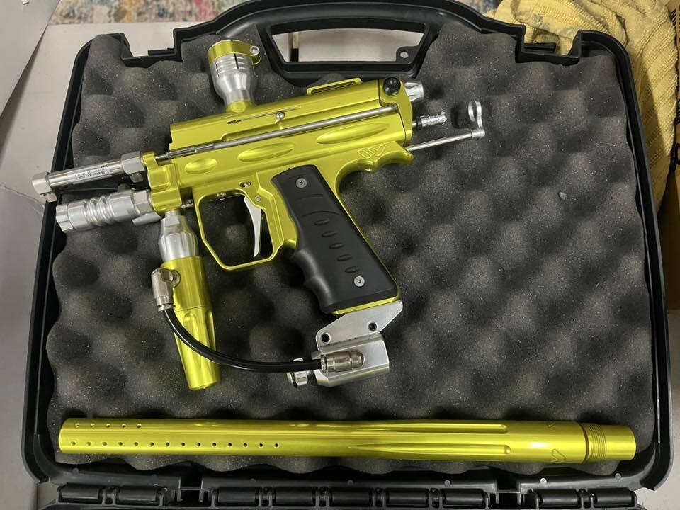

            Gen 3 works bodies
            Mini and Full bodies / three/four various sized eliptical spoon scoops replace pill shape milling - works branded “W” milling on hinges, bodies, and “W” on back of barrels. Works branded LPR, ccm style smooth ram, Work 3way / Wire Detents, Works milled ccm style HPRs.
            assembly was kinda varied, just like with the 03 j2s. various components on different guns. Seen Excel Barrels on some, etc.

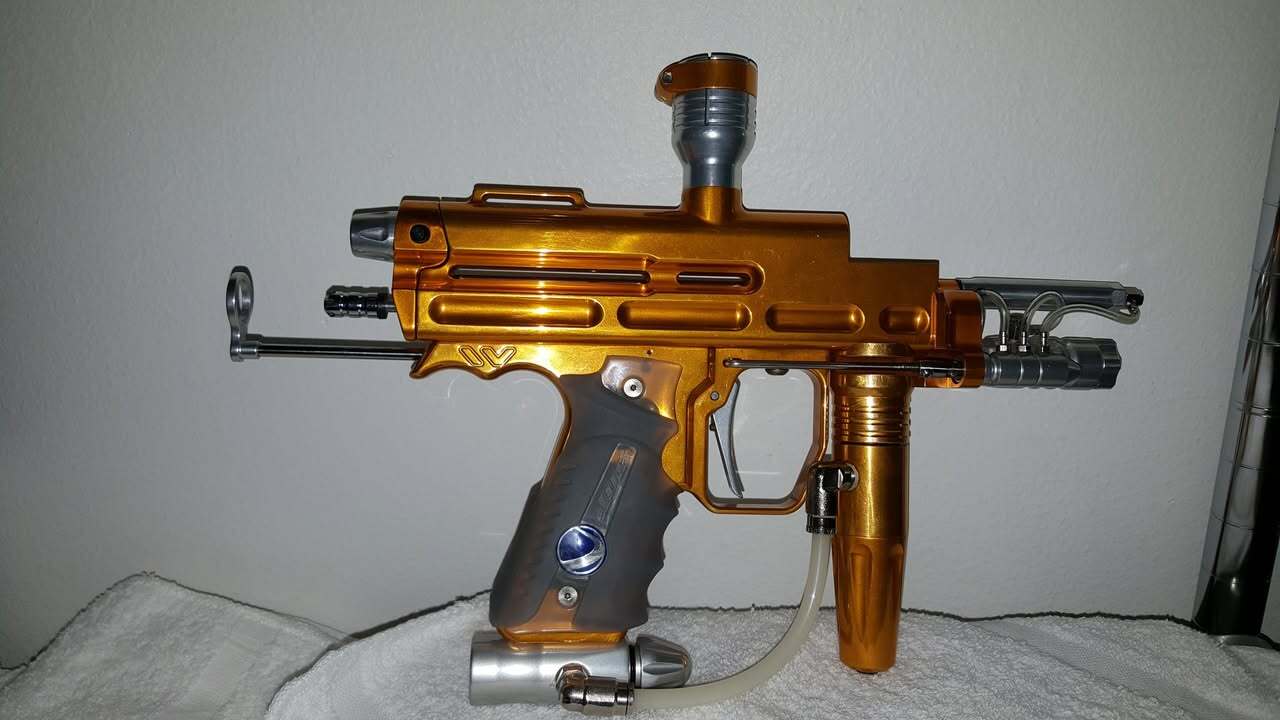

            • BrendanB
              Autococker Fan
              • 1100
              • Louisiana

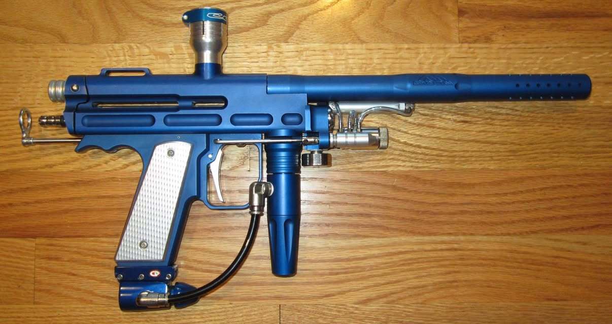

              Here is my Gen1 mini Works merlin. These are stamped with AKA serial numbers in bottom of body. These all came with gen1 MacDev Gladiator HPRs. On works bodies some have rails on top and some are smooth. Most have P blocks but some are standard 2k cut blocks.
              Barrel / fittings / ram / medium neck has been added to this from its original config
