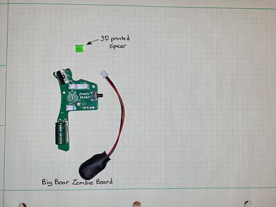

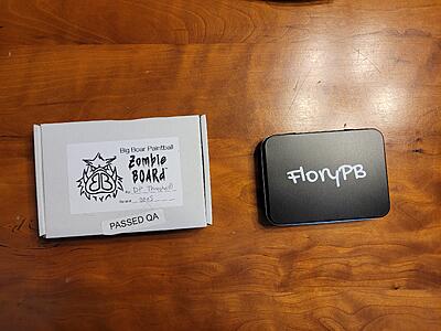

                    I have a Threshold that I am trying to breathe life back into currently.
                    I picked up a Big Boar Zombie board last year (S/N 0005).

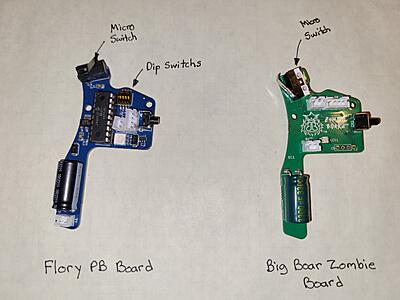

                    The thing that turned me off to it was you had to "glue" a 3D printed spacer to either the switch or your trigger.
                    I put it aside and haven't done much till I watched a couple of Flory Tube vids.
                    So I picked up one of his boards too.
                    The thing about the Flory is, he positioned the switch differently, so that you can bend it to get the trigger to actuate it.
                    I still don't have enough to get it right, so I might need to create a shim for that one to work too.
                    I will try to get some pictures tonight of both boards to show what I am talking about.

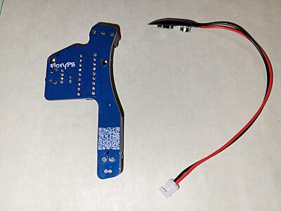

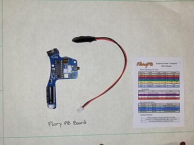

                    The really nice thing about the Flory boards are that he prints a UPC barcode on the back of the board so you can scan it and then pull up the programming instructions.
                    I thought that was a really nice addition.

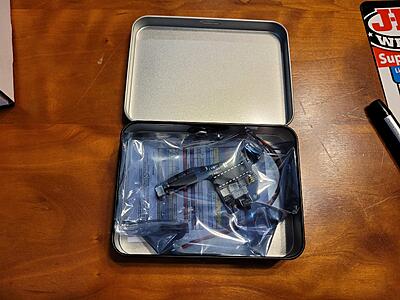

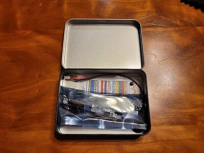

                        So here are both boards for a Threshold.
                        I broke them down to show what you get.
                        This gallery has 5 photos.
                        • PBGunny
                          Seasoned Shooter
                          • 166
                          • Northern IN

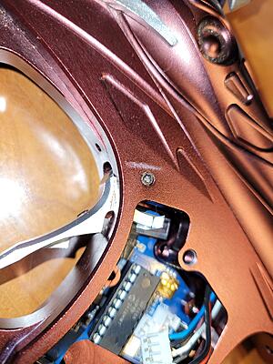

                          I ended up installing the Flory PB board last nite finally.
                          Also included a pic of the back of the board to show the UPC code.
                          After slowly bending the switch and trials, I finally got it in place.
                          The tab stuck up too far and when the grips were installed, it wouldn't allow contact.
                          Ended up bending it some more till I had clearance.
                          Programming was pretty easy, even for the color blind guy.
                          Very happy with it.

                            Here is both of them for a comparison to show the switch placement on each board.
                            Sorry for the spelling... Was ready for bed time, but wanted to get pic.

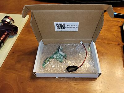

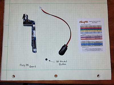

                              Also got a board for my G3 IQ.
                              Noticed this one has a 3D printed button with it.
                              Will get to installing this one later.
                              Also... His instructional videos on Tube are really quite good.
                              Very helpful when installing.
