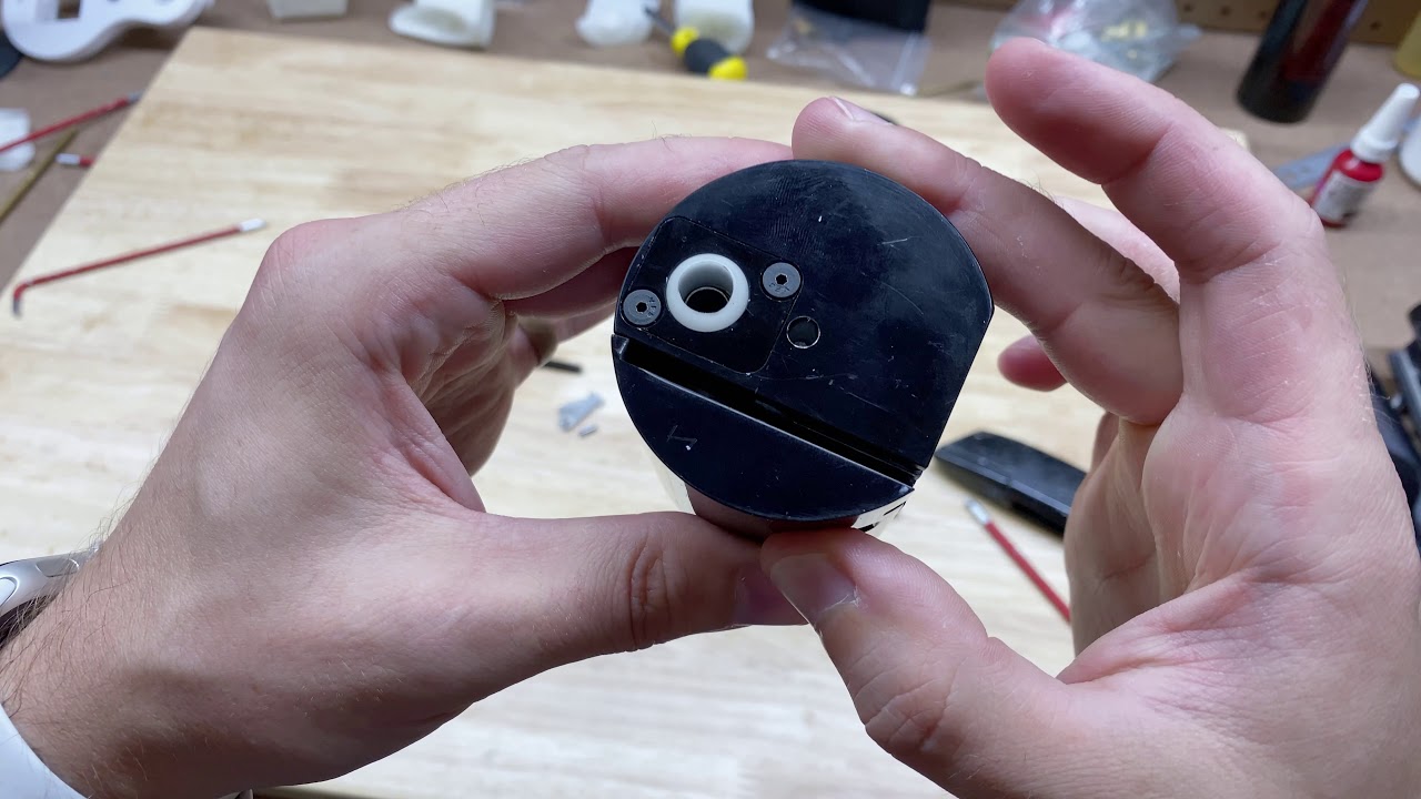

    This comes up every so often, so I put a quick video together:

    there should be a loop on the bottom end of th emid spring so that it stays in place in the groove. dont put pressure on the hammer lever when you start. once you get it lined up with the pin fip the hammer lever iwth your pinky. it just snaps together. doing it that way, the spring doesn't launch. i made a video of it but I don't know where it is.
    you can put the pall and spring in after it is on the body. the pall spring plate is there so that you can do that. just remove it

      I think I found the page where your video used to be, but it doesn't seem to exist anymore. Did the springs start as clicky pen springs? I can break open a bunch of clicky pens and steal their springs.
        They all used to be on photobucket. then they turned into a bunch of knobs and i downloaded everything someplace.
        yeah just cheap pen springs. the pall spring needed to be a specific type. just a fancier gel pen with enough loops. cheap pens don't have enough loops for that.
