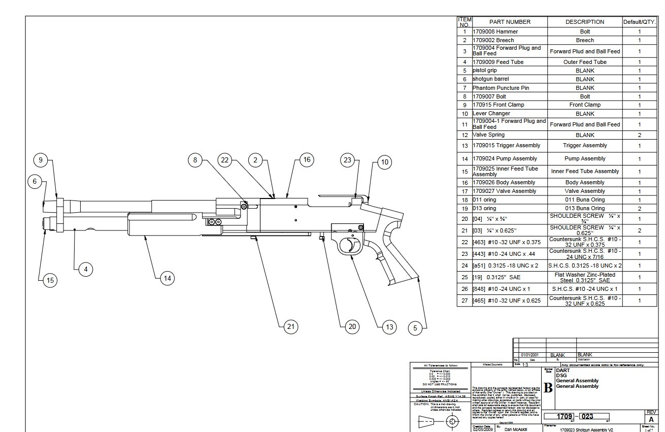

    Part number 25 in the manual, the small washer. I can't for the life of me remember where it goes. It is listed in the diagram, but not shown anywhere.

    Hmm, maybe under #21, between the bolt head and the pump? I'll go check my dsg...
      Hm nope that wasn't it. Might actually go to the bolt holding the grip on now that I think of it, looks like #26 is the bolt.

      • dukie
        • 131
        yep. thats the only 5/16 bolt on it.

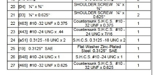

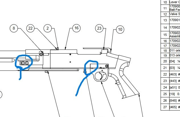

          Can someone give me the measurements/angle for the pump handles counter sunk screws and also the measurements on the socket head trigger assembly screws needed? I'm too dumb to figure it out!

            #10-24 x 7/16 for the pump arm screws
            i wanna say that the trigger block screws are #6-32 x 3/4. they are on the trigger assembly drawing.
