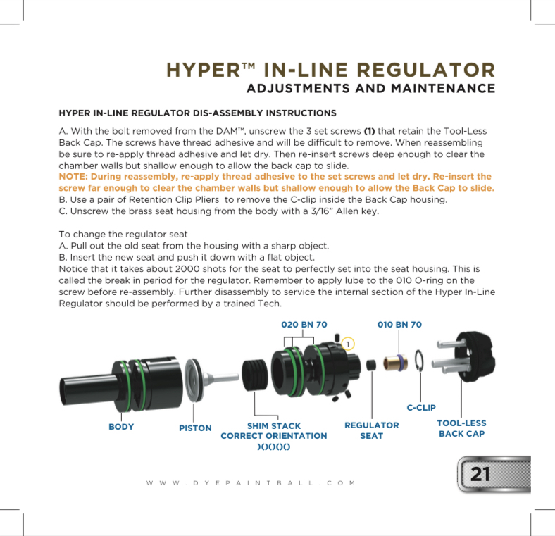

        After you confirm it’s not an over pressure issue I recommend changing out your reg seat. You can find the manual on the Dye Website. But I screen shoot the important part for you. While you have it apart check out the orings make sure they look ok as well. Click image for larger version  Name:	7B8B8665-C22B-4DA1-A631-34105DDBE441.jpeg Views:	0 Size:	273.0 KB ID:	111916
          Oh make sure you pay attention to the shim stack orientation. Make sure it goes back together just like the picture above. (Light hold Loctite on the 3 set screws) pay
          attention to the note in yellow above it’s important. You will need to get a pair of retention clip pliers. To remove the C clip. You can find those just about anywhere cheap at like harbor freight if you don’t already have one. Amazon has em for like $8 “c clip pliers”.

            Chuck is right, your problem is probably burned out reg seat.
            If you don't feel like addressing that, try lubing the hell out of the inner bolt can oring. Its the oring that sits nearest the front inside of the bolt can. If I don't sufficiently lube that I develop a small leak in the middle.

              Thanks guys I finally got it worked on, I’m definitely going to have to learn to repair this guy, I just never had much experience with electros and don’t want to make anything worse. I guess the leaking from the middle was a reg seat oring or something? That I never would have guessed so I’m glad it got repaired.
              next time I will look at learning to take it apart, heh.
