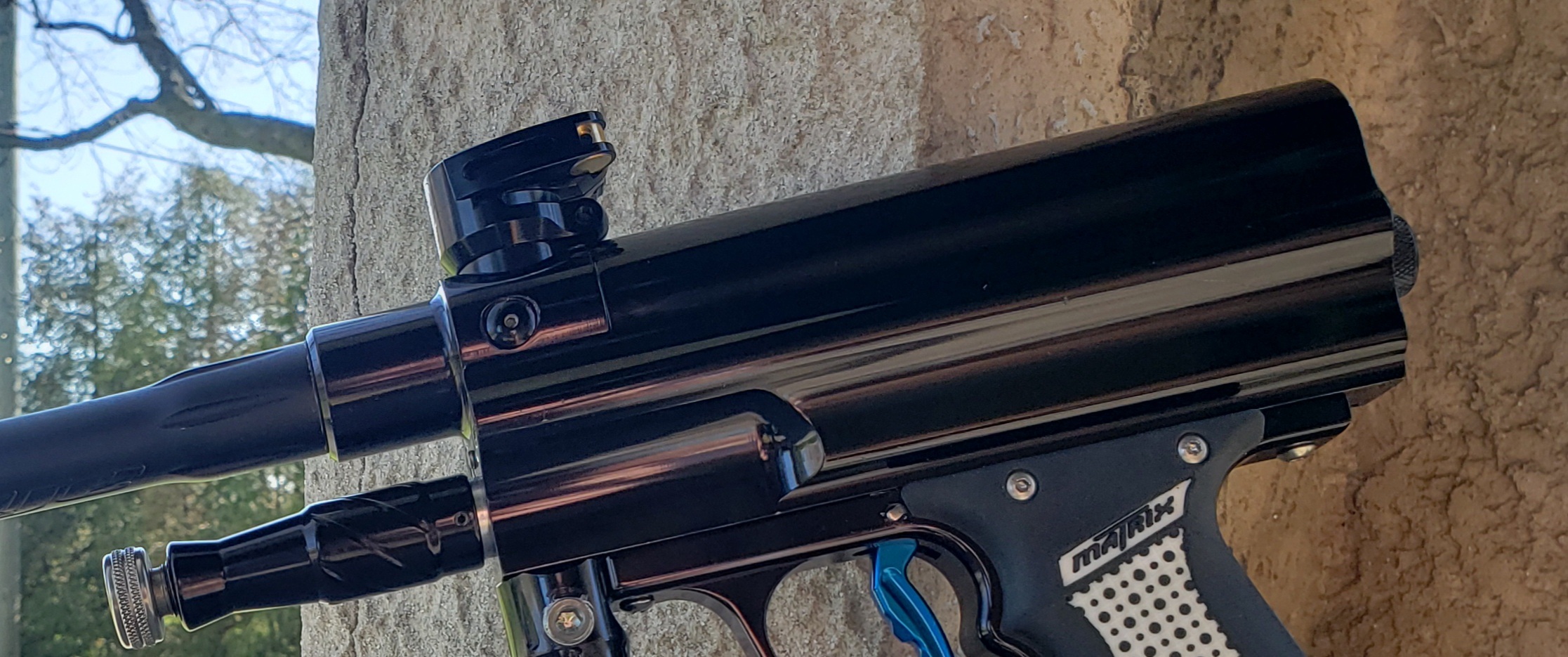

            I read this thread a couple months ago and realized I had the same issue last summer when I was using my Matrix... and having found a spare breech on here, decided to modify my existing breech for Mini detents.
            I'll know how they work this summer when it comes out to the field with me, but preliminary backyard testing shows [Borat voice] great success [/Borat voice]. They're almost invisible at first glance, so you have to really look to see what I did.
            Obviously not something many will be willing to do, but I'd rather have a functional marker than one that sits on a wall looking pretty.
