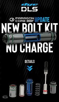

    DLS Upgrade
    DYE DLS V2 core upgrade.
    This gallery has 3 photos.

    IMO it's a little luck of the draw. I didn't have any major issues to start with mine. My body only needed one of the thinnest shims with the V2 kit so I suspect the tolerance on mine are pretty good compared to some others. I installed the V2 bolt and made some setting changes they recommended and it's shot great ever since.
    Lurker has a V3 kit in testing but you'd have to 3d print the parts as they haven't done a run in metal of them

      After getting the V2 parts installed, my DLS has done well. It's shot is super unique, especially when compared to everything else Dye has released in the last decade.
