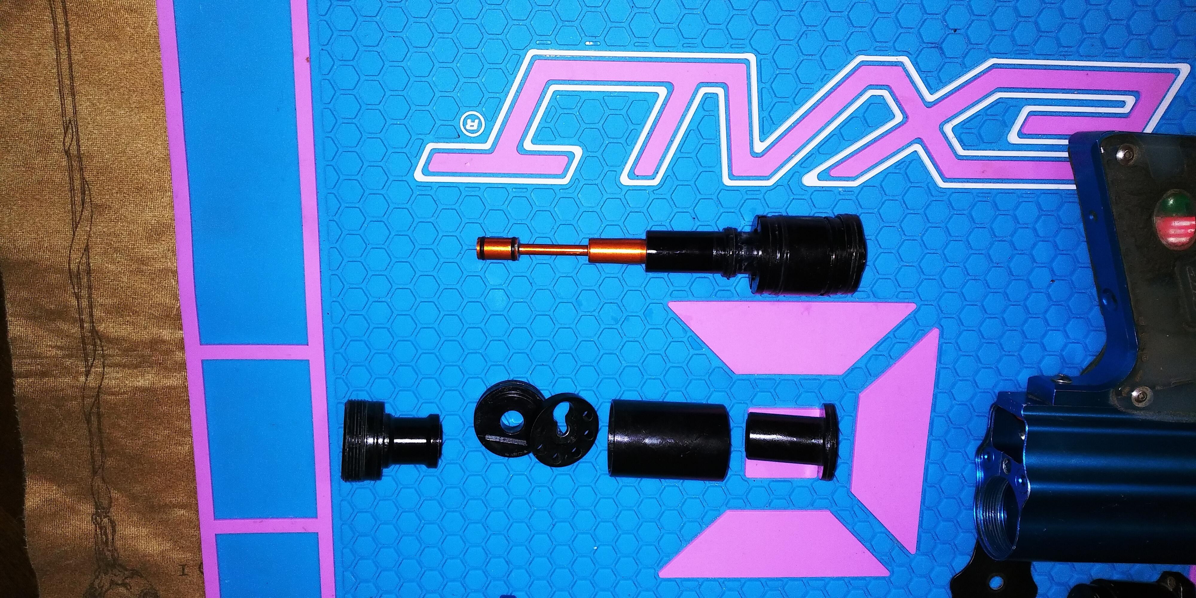

    I am attempting to rebuild my old Gen E matrix to get her ready to go to a new home. I purchased this gun almost 20 years ago and can not remember what bolt kit it has. I have been searching the interwebs but have drawn a blank. If any of you matrix aficionados out there can point me in the right direction that would be amazing. Thanks

    Stock gen II bolt pieces and a FreeFlow bolt w/ orange sail

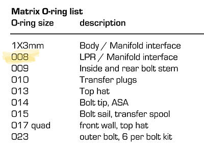

      I appreciate the info, as I have dug deeper into the matrix I have found that someone used a petroluem based lube and destroyed all the body orings. The orings at the ASA and LPR where just black sludge. Would you happen to know the size of oring on the end of the Dye mini rocket LPR?
        Looks like a 008
          That is very helpful! Thank you for the help.
