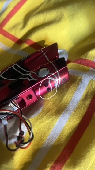

    Turns out I hadn´t changed ALL the o-rings. DM6 manual led me to the tiny 007 o-ring inside the LPR, which was crumbles.
    So everything in order now.
    -EDIT-

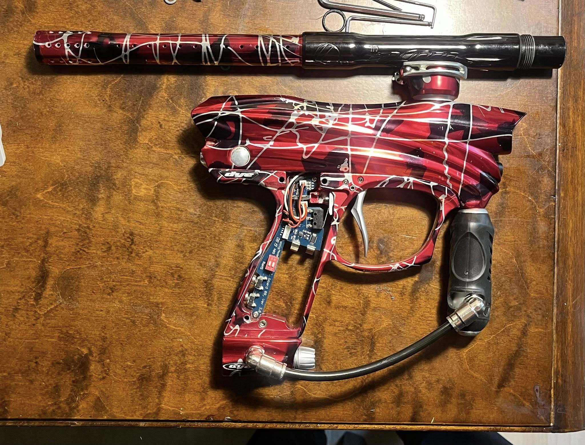

    Yeah so I got me a cheap DM8. I think it´s Billy Wing gun.
    Gun shoots fine, but it has a leak from the rear grip frame bolt hole/vent hole.
    Is the leak from LPR or bolt kit? It´s been so long and my DM14 never has any problems (except with electronics).
    I´ve changed all the o-rings in bolt, hpr and lpr, but I didn´t have the reg seats.
    689470634_10239545401884695_1248411763398863335_n.jpg IMG_8515.jpg 688507575_10239545110237404_6450076910892973209_n.jpg ​ ​

      Lpr needs a rebuild
