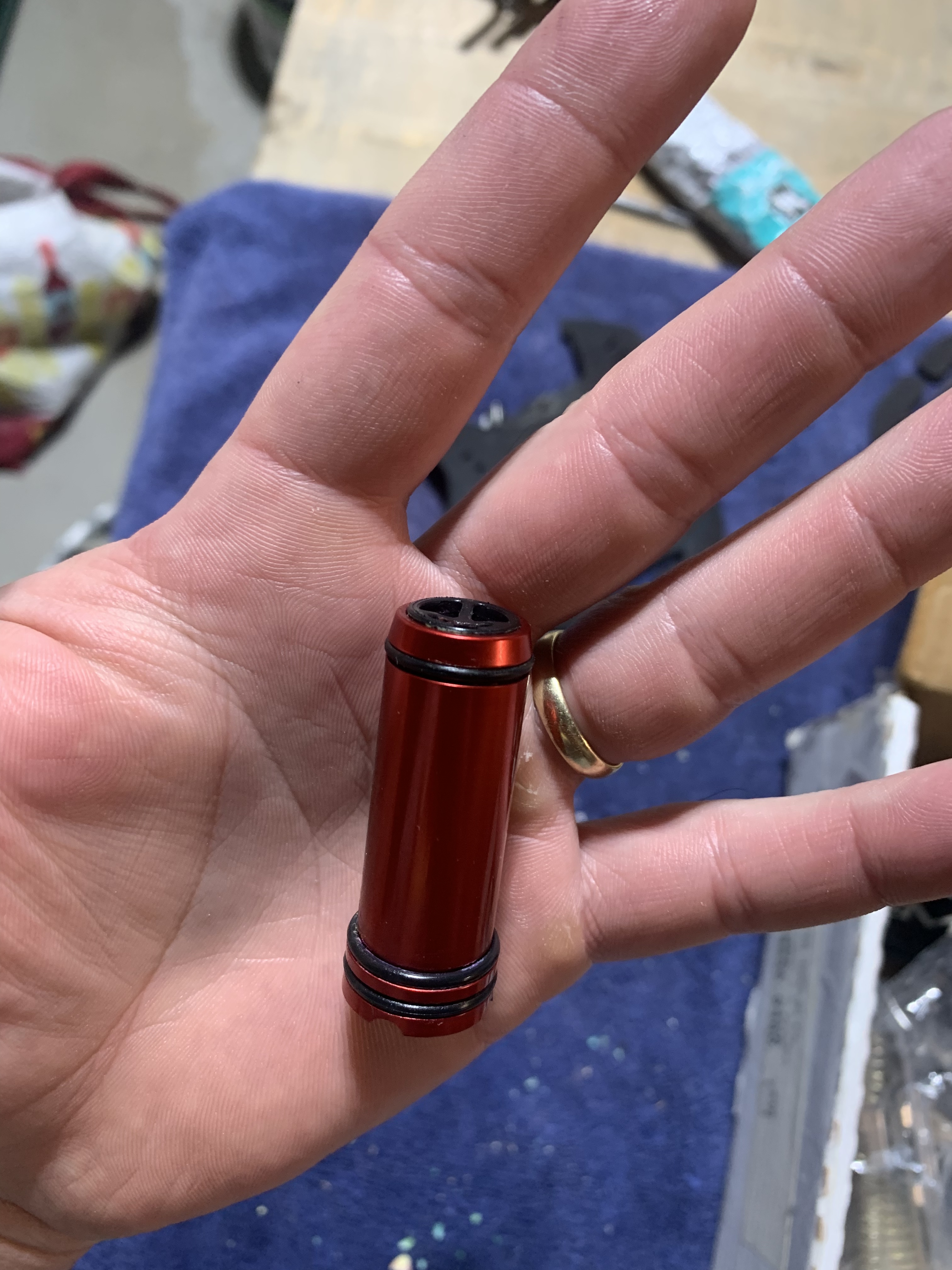

        Well, for anyone who might have the same problem, it turned out to be linked to the soft tip bolt I was using.
        stock bolt worked fine
        brickhaus’s techt bolt worked fine
        no clue why the soft tip one was causing problems, but now I recall the guy who sold it saying that the stock bolt was installed when I got it because he didn’t like the soft tip one.

          Do you know if the soft tip bolt was from PE, or an aftermarket?
            • 6380
            Is probably just one of the oring on the soft tip bolt. But you’re better without it. M170R don’t have paint breakage issues.
            Sell it to someone who thinks it’s an upgrade.

                I’m not sure who the manufacturer is, but the orings are a definite possibility. I never swapped them to see if this bolt would work with new orings.
                  That is a Gama Core Super Soft Bolt made by Stanchy customs. Clean, replace the orings, and lube the bolt and see if that corrects the issue. Just looking at the condition of the bolt I would consider doing some maintenance on the mech valve in there as well. The only time my 170 gave me issues was when I didn't clean my mech valve for WAY too long.
                  Link to the bolt:
                  https://stanchy.com/collections/bolt...uper-soft-bolt

                    Yeah, that's a Stanchy. I have one in my Gmek and it's never given me problems.
