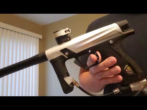

            #22
            First impressions of the Bone are pretty good. It's comfy. The meaty part is nice and rounded. You're supposed to "rip" it with your middle finger on the flat spot on the bottom, which you can totally do. But I have no problem just doing that in the middle of it like normal shoes.
            The two little tabs that stick out is where this thing becomes interesting. They're meant to be used as a double trigger. And you definitely can. I wear size 9/10 gloves. So not huge hands, but not small. I can definitely get two fingers on it. And, I can kinda walk it with my finger tips. I know walking the trigger on a hair 45 defeats the purpose of mech play. But the Automag enthusiast in me is all "oooh... new pneumag..." I'm definitely not electro fast by walking with my hand in that position, but I'm definitely quicker that just normal trigger pulls.
            That said, I haven't live fired it yet. I actually haven't even installed the hair. I want to take some speed comparison videos at the field on Sunday, so I'm leaving it stock for now.

                #24
                So Sunday was cancelled, as the renegade field I was going to play at is run by a scenario team, and they have an event this weekend.
                So I took some (really shitty) video of the stock switch vs DW, and HOLY CRAP. The vid is uploading now. I'll post it when it finishes. But the stock switch is approx. 2 lbs. The DW is about 8oz. Insane. With the Bone GTR, the trigger is completely walkable. You'll easily go from 7ish bps to 10. Easily. Insane. Feels like a pneumag, or well tuned Automag ULT.

                #25
                Here's the vid. Sorry for the terrible radio voice, and radio face. Lol.

                  Thanks for the vid. The glee in your voice is pretty evident.
