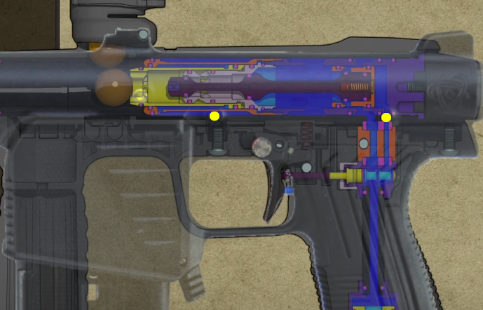

      Send Simon an email through inception, he sells the parts as an unofficial kit . As well as instructions for what to do.
      I whipped an image up of where the holes line up compared to the internals.
