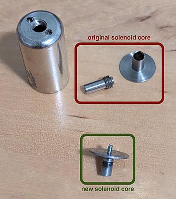

    Here's what I'm testing. I don't know why, but it seems the solenoid coil itself is not producing the same magnetic flux as it did new. I don't know how this is possible and thought since these coils are just wire, they should either work or not work and not show degradation in performance. If there are any electrical engineers or physicists here who can chime in, that'd be appreciated.
    So to make up for the reduced coil performance, I made a new stationary core with the most mass (i.e. attempting to maximize magnetic flux density - https://en.wikipedia.org/wiki/Solenoid) possible by measuring and CAD-ing the solenoid coil + housing + spool (accounting for the valve throw). This new core is slightly larger in all dimensions than the original core so it should have more "magnetic flux density". Note: I don't think the big thin flange I have here contributes to magnetic flux since it sits outside the coil but it was easier to machine this for retention instead of the tiny threads on the original core. I'm not sure ​what the washer/flange/tube component of the original core is supposed to do either.

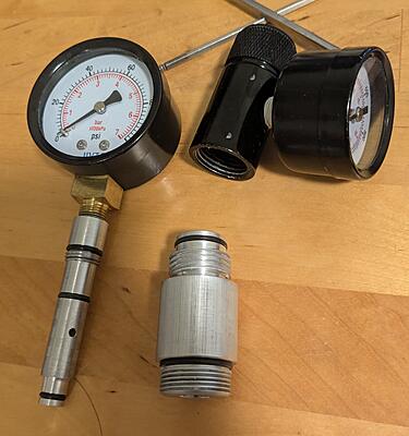

    The issue I have now is low velocity, despite maxing out the adjustments on both HPR and LPR. This is the same problem this gun had ~10 years ago when I first got my hands on it. I'm not sure if the reg output pressure ranges have drifted off from new, so I turned a couple pressure testers to see where it's sitting. Now, I just have to figure out what these pressures are supposed to be from the factory.

      Update on this before I forget again: velocity got back up after bumping up the dwell a couple ms. More thorough testing is needed.
      • imped4now
        imped4now commented
        Very cool project. The required additional dwell time supports the weakened coil performance. But, the "why" remains.
