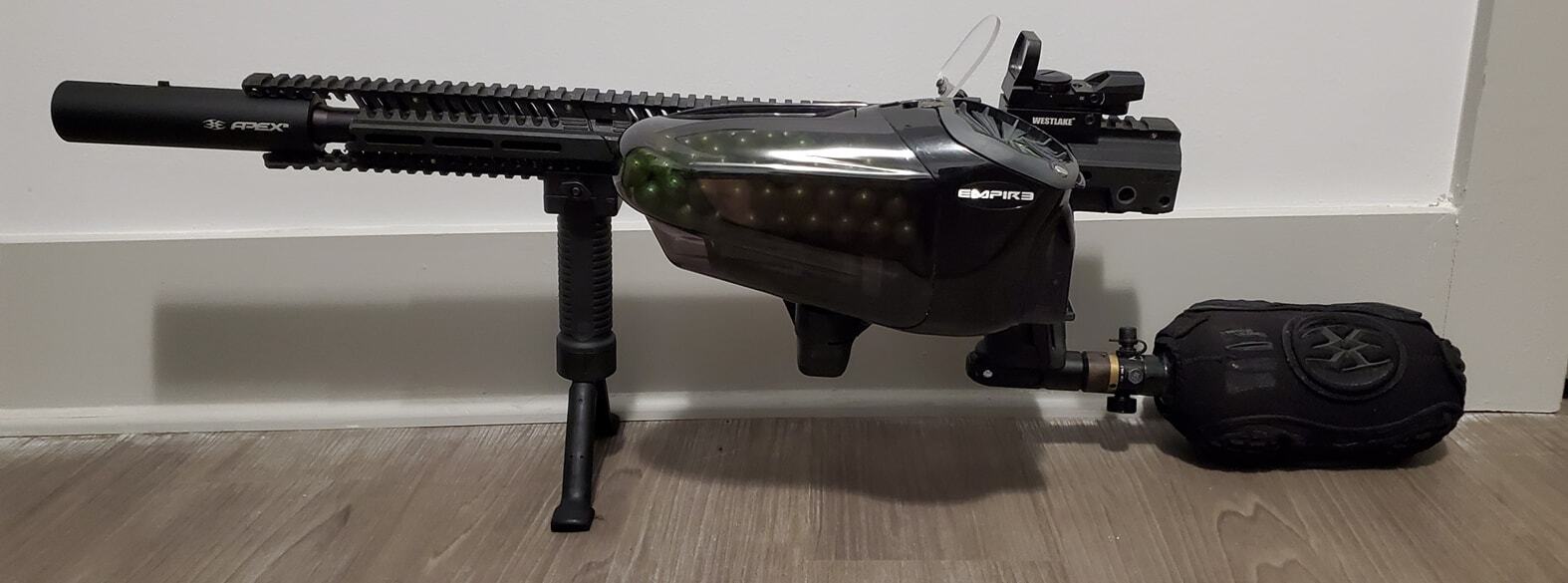

      I normally use a 10" one-piece barrel with my MG100, or rather, it's an old Kaner 2-piece with the 10" tip that I loc-tited together to keep the back from getting stuck in the MG.

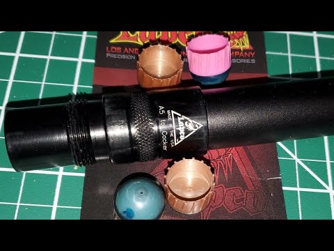

      I did find that I was able to get a LAPCO Desert Edge Apex-ready tip to work with the stock Eclipse barrel back, though I had to dremel off quite a bit of the front and inside of the forward shroud to allow both clearance and to provide a bit of exposed barrel front that could be gripped and turned to install and remove it.

        Relevant?
