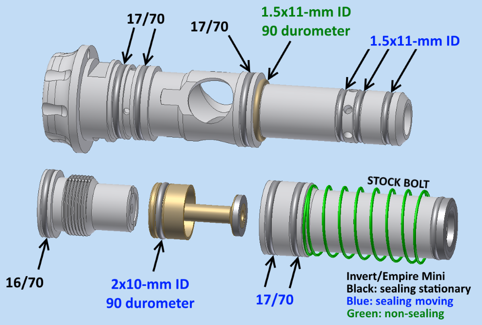

        I am going through the Oring store and used this list of Orings from ZDSPB to put mine together the only issue with the Oring store is you have to buy large quantities.
        Click image for larger version  Name:	mini_firingassy_diagram.png Views:	0 Size:	255.0 KB ID:	235288
        Jam up, thanks for that diagram. I forgot about zdspb.
