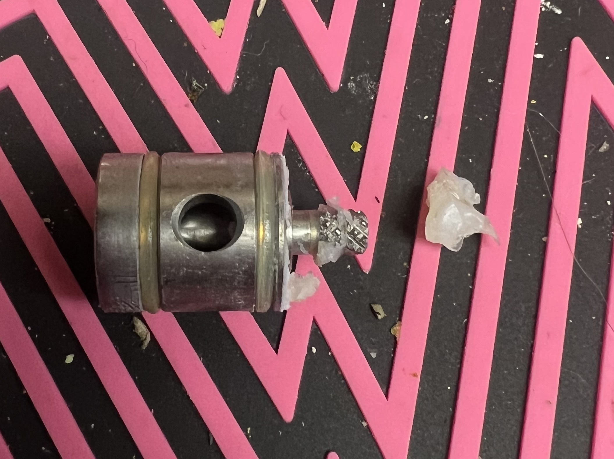

    ID valve! My Sniper valve stem exploded in my marker. Fluted pump rod is nice as well. The stock pump handle will swell and will need to be sanded
    Click image for larger version  Name:	IMG_9144.jpg Views:	0 Size:	542.4 KB ID:	441311
