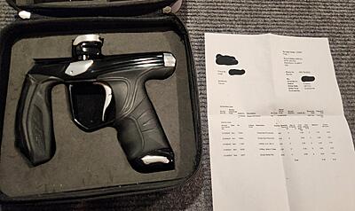

    I was waiting in line to check in last weekend and spotted a Syx on the wall of guns. I have asked the price several times since Spring, so I asked again. The owner told me it had a leak he couldn't fix and he was tired of it, so 100 bucks. I handed him a fresh hundo and took it home. By 10am Monday, it was on its way to Kore service dept in Ft Wayne, IN. I saw that it arrived there on Thursday at 9AM. I came home from the field today to a box from Kore. They had fixed it by 1pm in Thursday and shipped it out same day at no charge. So rare in this day and age. Its sealed up tight and shoots great! Many thanks to them.

        Where was the leak coming from if you don’t mind me asking? I’ve got a Syx & love the way it shoots but it’s got an intermittent leak from the asa.
        Also, i see it’s still got the long asa lever. Kore was upgrading the Syx 1 to the 1.5 for free. You should check into that.

          The leak sounded like it was coming from the Solenoid area. Couldn't hear it coming down the barrel, but could hear it coming from the top of the grip side.
          • homerj
            homerj commented
            Ahh. Different leaks.
