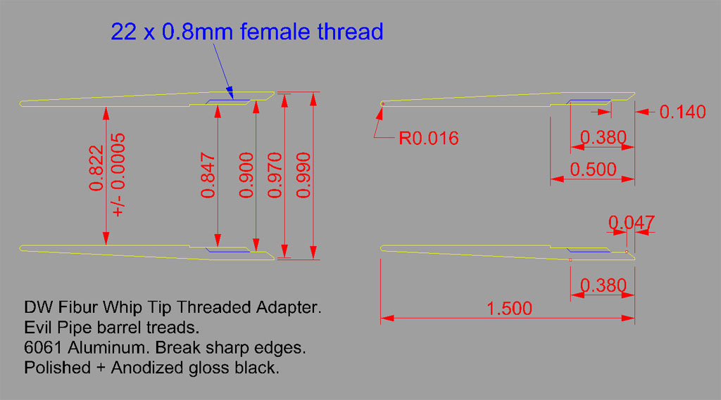

    Just heard back from Deadlywind, and they were kind enough to provide me with an old print for the tip they used to make...

    Now I can design and print tips for the PCS USP pistols, and pipe backs! Thanks!

      Nice. Just remember to reduce the bore size of your barrel front to .70 or .695 unless you are planning on gluing in carbon fiber tubes like DW. I wonder what other threads they have resources for...
