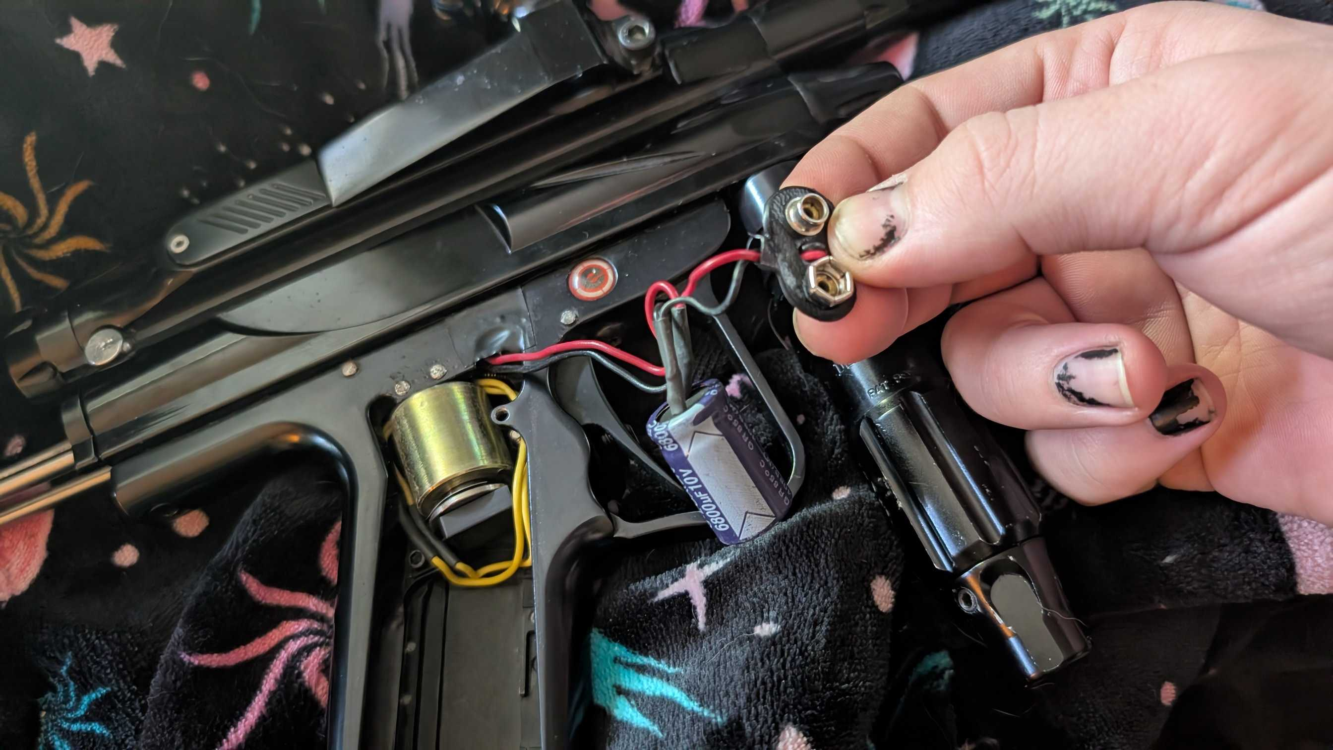

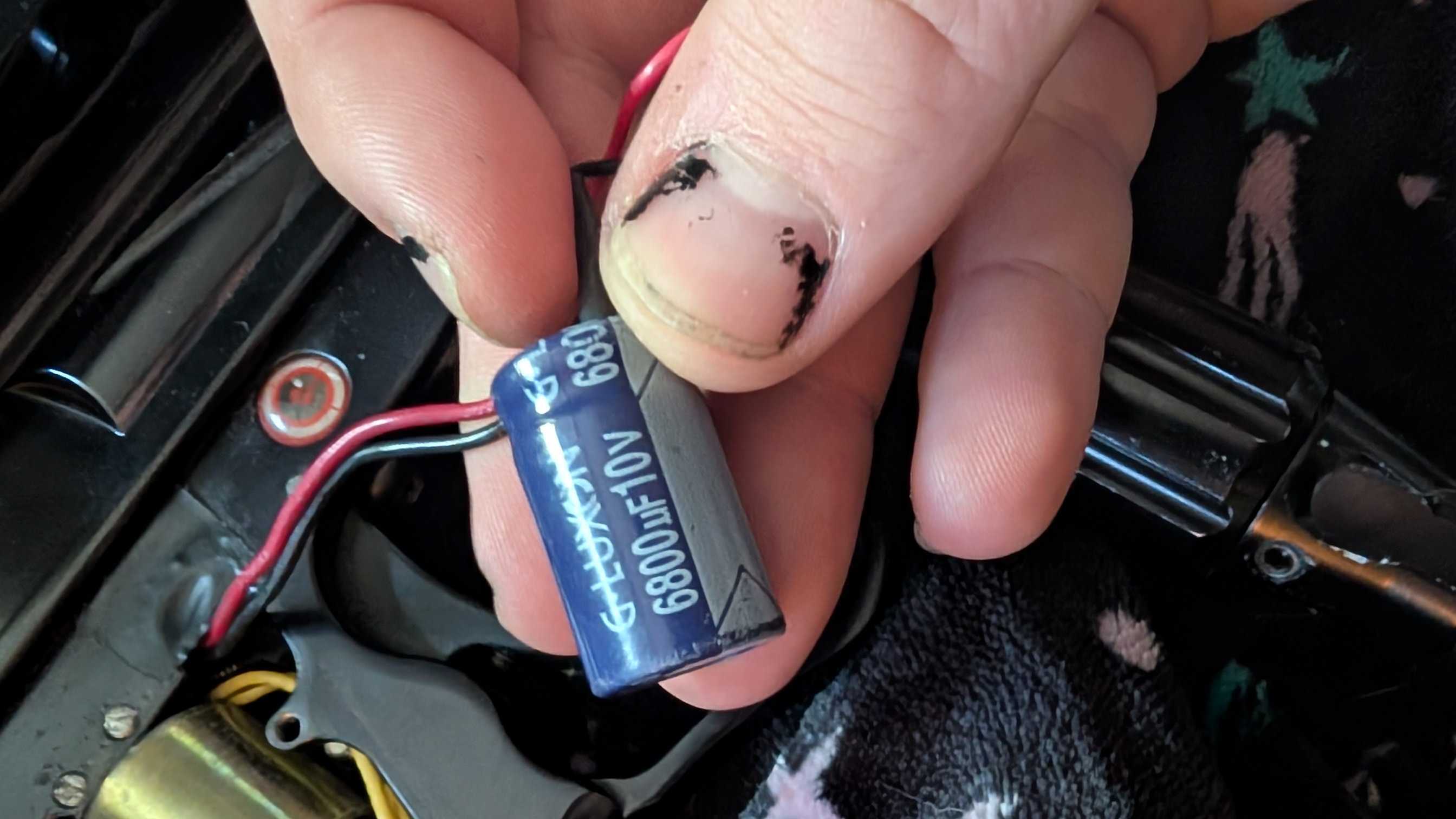

    Bought Walkers Evil Omen. Click nice and the bolt catches, but haven't been able to air it up just yet. First issue I'm looking at though, this Capacitor is huge. Not really enough room to fit the battery and capacitor together. Is there a specialty battery I should be using in here instead of a 9V or is there a smaller capacitor I should replace this with?

    I always used just regular 9V batteries. I left the capacitor in.

      There is a milled out slot in the grip frame, the capacitor should go behind the 12V.

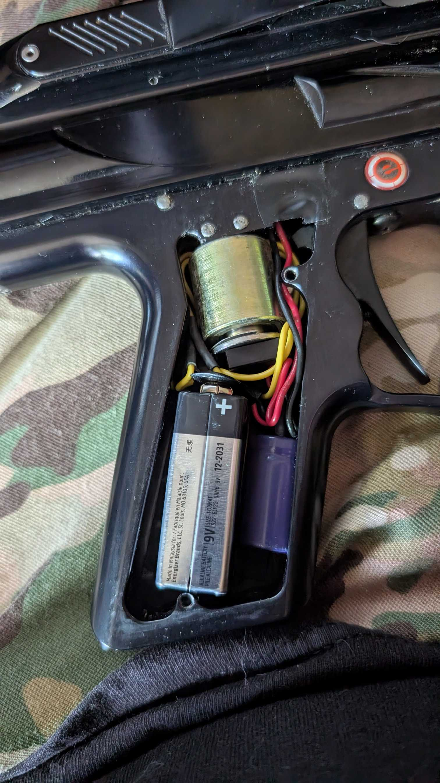

        I saw that pocket and had assumed thats what it was for. I ended up fitting it with the capacitor in the front pocket and the battery mounted the wide way, fitting into the slots in the grip. Its definitely a TIGHT fit.

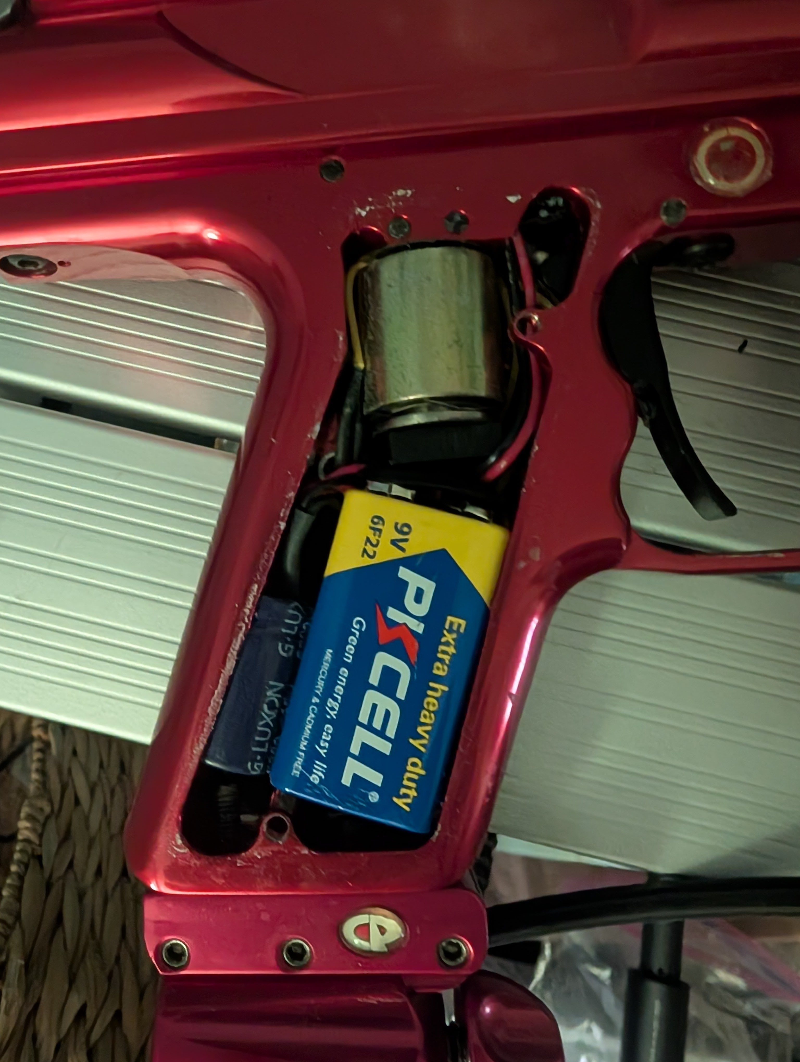

          Do the grips fit flush when it is sideways like that?
        • NabyArmeDrommel
          NabyArmeDrommel commented
          Yeah. It seems like the pockets on the grip are meant to fit it.
