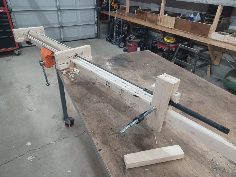

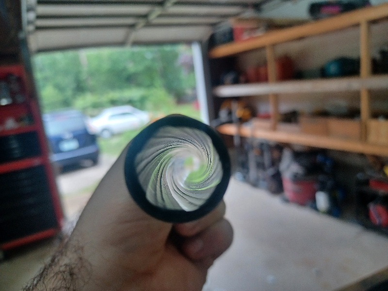

      I actually made a rifling machine a couple weeks ago. Its a little janky. Could be made better with less slack in the system, but it works. You might wanna try building one so you can experiment yourself
        That’s so cool! Can you riffle some .680 brass for me?
      • markdem
        markdem commented
        Chuck E Ducky sorry im not doing any rifling in the near future. Setup is still very prototypish and has a lot of kinks.
        All good just thought some rifled brass would make for a fun build project.
