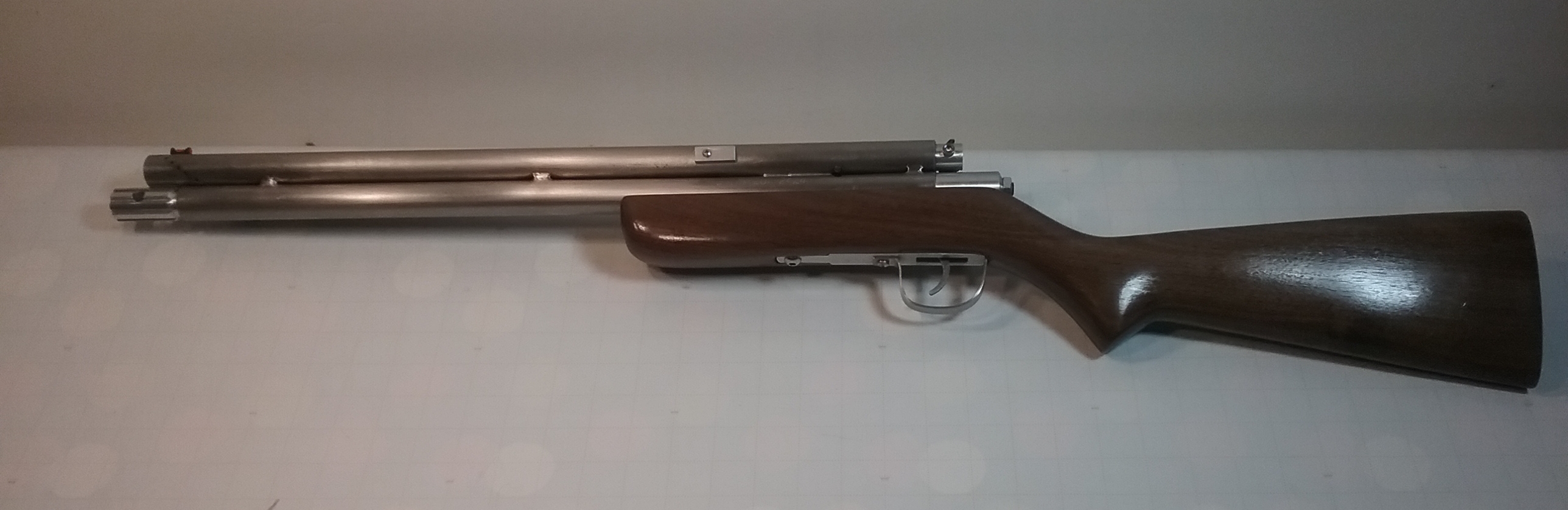

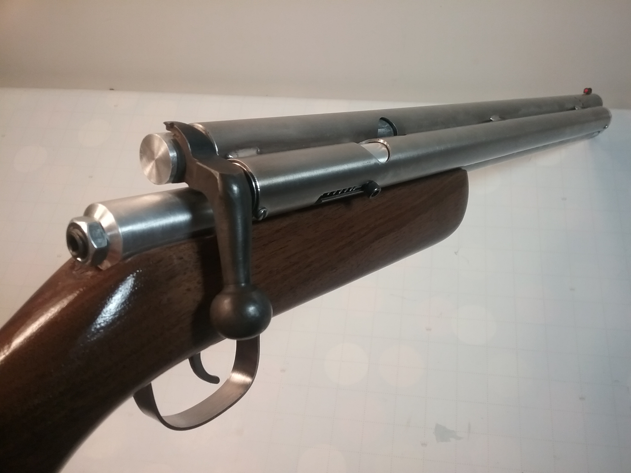

    We just completed a custom M20B in stainless steel. It has a 20 inch barrel, 03 bolt handle, Tru-Glo front sight, black walnut stock, Magnum SP valve, and our new trigger group with a locking RVA.

    That's a beauty.

      Was this build the 1st using your new trigger group?

              Yes. We have used the new back block before, but this is the 1st with the new trigger that is not a test configuration. This is also the 1st with the long RVA screw and lock nut. The old triggers were the last Sheridan rifle part that we used.

              Where... the fuck.... did you find stainless tube with a .68 inner diameter?

                It's out there. We've been using stainless for years.

                  The reason we started working with stainless was the cost of brass was getting outrageous due to limited suppliers. SS was easier and cheaper to get. That of course was years ago. We have since located a brass supplier. So now both SS and brass is outrageously priced.

                      Just curious what is the overall weight? I would suspect it is considerably lighter then a Brass build given similar wall thicknesses. Looks real nice.
