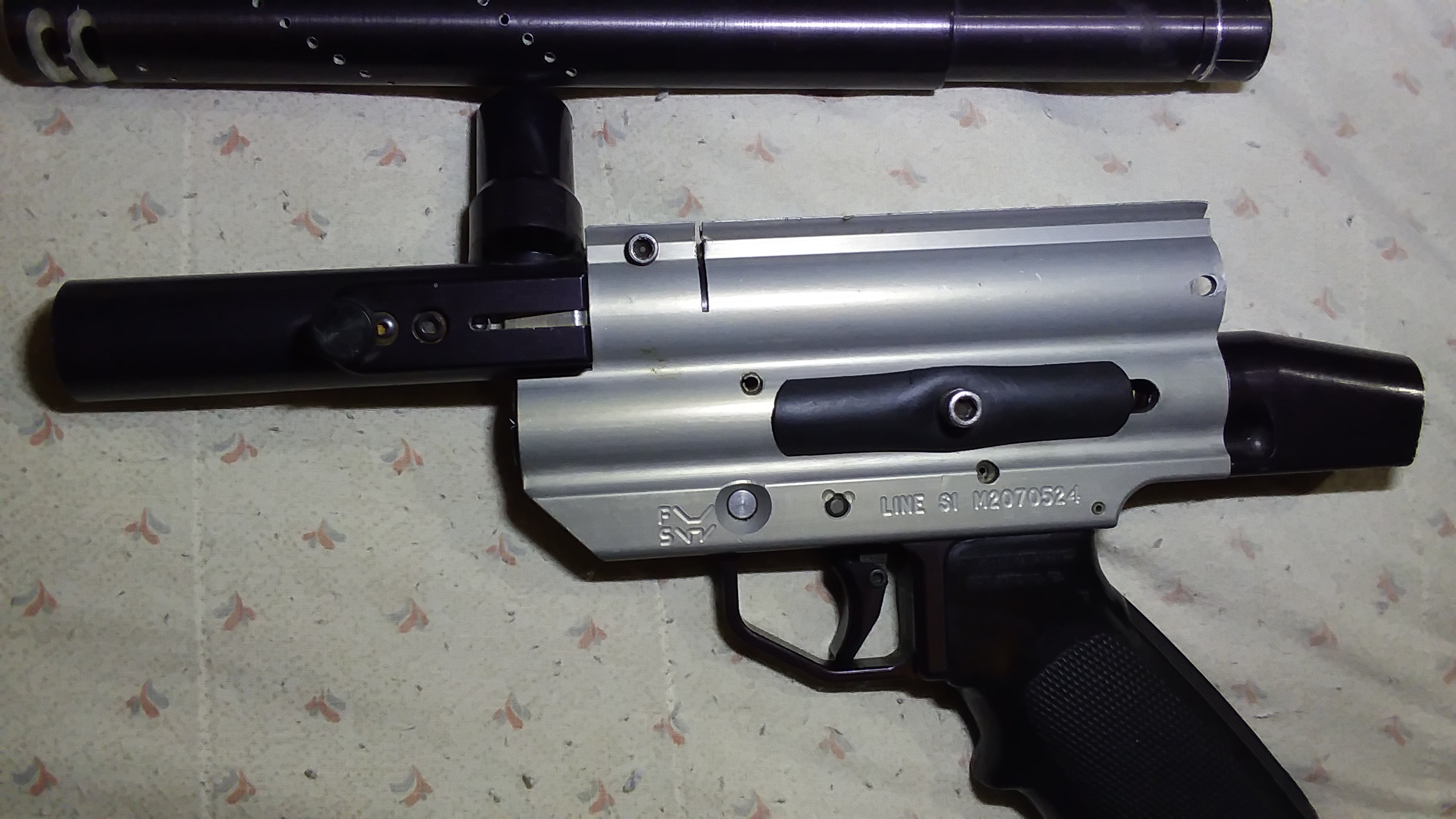

    image_2730.jpg Do any of you have personal experience with Line SI Promasters? Do they require anything special regarding a service/rebuild? I have not torn mine down, but it's supposed to be complete.
    EDIT: Rear Upper Bumper and Screw are missing.
    I found the Pukin Dogs Promaster page, but have not digested it yet. https://pukindogspaintball.com/bg-guns/PROMAST.htm
    These guns look to be fairly tunable, but may require unobtanium parts to sweet spot.

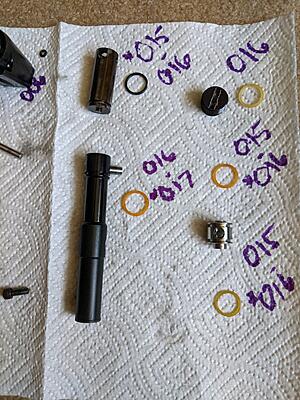

              O-ring investigation, based on a print out sizing chart from Captain O-ring.
              Keep in mind, I have no idea how old these rings are and they may have swollen or stretched. I put an asterisk next to the better fit where it appeared to be between two sizes.
              The little ASA air passage ring is confirmed size 006 Buna according to the manual. The bolt o-ring might be the same material.
              I'm not sure if the coloration between the other four indicates a different material, or possibly more exposure to oil or CO2 on the bolt and the back of the valve.
              My plan is to buy a handful of o-rings in sizes 015 - 017, in different materials if I can get them, and see what works.

                Success! I just did a rebuild of the above rings and resolved all of my leaks.
                The good news is that I was mistaken on most of the o-ring measurements, and in fact the majority of these rings are 015. It was painfully obvious when I tried fitting 016s that they were simply too big. I had both buna and polyurethane, and used the harder poly where the originals seemed stiffer, on the rear valve and valve retention screw. The front valve and hammer got buna. This means your primary o-ring to rebuild this guy is the standard tank o-ring
                For the bolt o-ring I did end up using 016 polyurethane. The groove is a bit deeper and it's harder to tell how well it sits, but it looked OK with a 016 and it's working fine.
                I thought I had a leaky cup seal last time, and I've ordered a Piranha valve stem to test it out as a potential replacement, but it turns out it was probably the valve o-ring letting air into the barrel.
                There are additional seals inside the ASA, but as that assembly is held in place with two spring pins, I'm not attempting to take it apart unless it starts leaking.

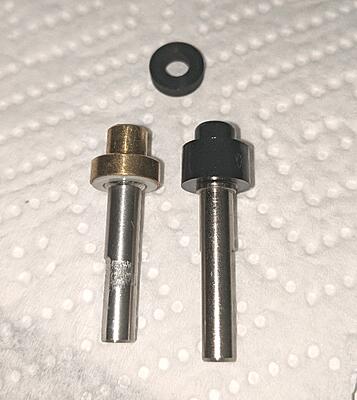

                  Cupseals:
                  As stated before, the cup seal is rebuildable, so it should not prove difficult to replace even if we had to punch our own from sheet material. But that's not going to be necessary.
                  Option 1: I picked up a Piranha valve stem from our fellow member sugarstump (https://www.ebay.com/itm/PMI-Piranha...P/161636373952), and no surprise, it drops right in. The stem is a bit longer, and I'm not sure if that affect the hammer impact to any measurable degree, but the cup is also longer, so it will increase valve spring tension. I get 11 or 12 shots off a 12 gram, and without changing anything else, the Piranha valve stem yielded 23 and 17 (I probably shot a bit faster the second time). Spyders and clones (which are ultimately Promaster clones) are going to give us lots of options. It's probably worthwhile to acquire a variety for tuning purposes.
                  I should say here that the pukin dogs article in post #1 says the Promaster "had valve pins with different amounts of flat sides for controlling re-cock pressure." Mine has a single flat; the Piranha stem has two. It would be interesting to know what options came with the original.
                  Option 2: a BT-4 cup seal should fit the Promaster valve stem assembly with a little cajoling. The OD is about right; the ID needs opened. I did not bother to try fitting it, but it's worth mentioning.

                    Promaster SI on the left, Piranha on the right

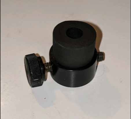

                          I just dug my Promaster out of the stack. For some reason I never noticed that mine is missing part #5 Upper or Rear Bumper. Is this really a bumper or is it just a cap to close the upper tube? If bumper, what material is it? (I did not see a spring on the schematic.) Is the "bumper" even required for proper functionality?
                          Just wondering... is that a two piece bumper made of a rubbery material in a metal cap like the later Cats used?

                            I think I read somewhere that the back cap is not really necessary. It's a round rubber bumper somehow attached to an aluminum cap, held in place with a thumb screw. There's also a bumper behind the hammer which is probably more important
